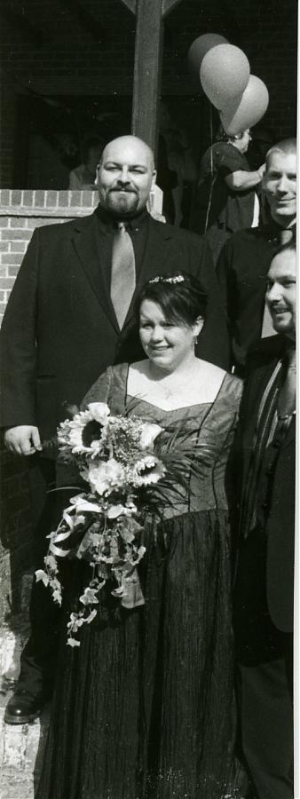

I did mention this wasn't left in an open tray; this was returned to a 2litre soda bottle every night. But I've been using this particular batch for 5-6hour stints for 5 days solid per week back in April for about two weeks before other things came up (crewing for am-dram production). So overall it must have had its 24hours out in a tray already.
Here's the test strip. Enlarging 35mm film to a little short of 8x10 (no overhang, leaving rough edges), lens stopped down two stops, 13second exposure, just like I was churning out in April.

For me, it's irrelevant that that well-used developer can be made to produce a satisfactory print unless it does so in a consistent manner. If it takes 3 minutes today with one type of filtration but another time/filter a week from now and yet another after that, that's no good to me at all. Developer is only useful to me as long as it's activity can produce the same results from the same procedure.

Very important, good point.

I have repeatedly pointed out that in this case, nothing has changed except for the age and colour of the paper developer. No difference in exposure or development times. Shrug.
