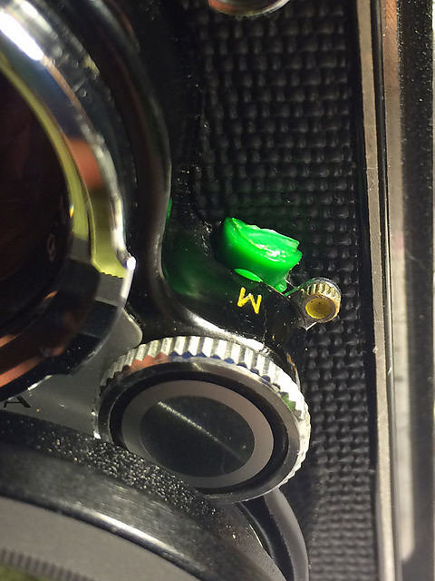

I thought I would share my solution to the MX lever problem that can damage things. As you may know, the self timer does not play nice with the camera in M flash sync.
Solution:
attachment.php

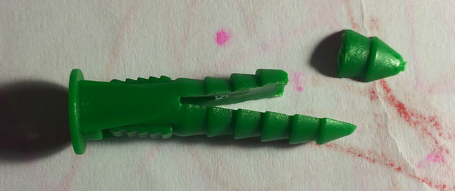

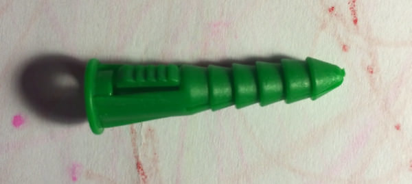

I think its a 14-16 sized ribbed wall anchor.
attachment.php
Cut a short piece off.
attachment.php
Jam in camera, removable, but very solid.

Simple solution! I always thought the rubber band looped around the flash sync lever and the lever at the bottom of the lens was factory equipment.
