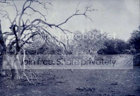

Just returned from a little trip to Dripping Springs Texas and thought I'd share a couple of 2 1/4 X 31/4 landscape paper negs. Just inverted them on computer,haven't tried to print them yet.Really like the look of paper negs shot in camera.

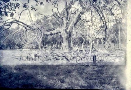

The second one is edge fogged from not inserting the slide all the way home before removing from the camera but kind'a interesting anyway.
Can't wait to enlarge them(and crop the fogged one...
Don

Thanks for the kind words Mike.The paper is Ilford multigrade glossy,not sure about ISO as the old meter I'm using runs out of ASA(ISO) before it gets down far enough but I'm guessing about 6.The reading I'm going by is EV 10 on the meter,results in 1 second at f 32 bright sun exposure. I am happy to see some faint clouds in the sky as they don't usually show up on blue sensitive materials unless they are very pronounced. Beside pre flashing the paper I did something unusual in that I "cooked" the paper before flashing.I've always understood that to keep unexposed materials for a time they should be refrigerated so to"age" the paper which is fresh I sealed it in a metal can and cooked it for 2 hours in a toaster oven at 85 degrees F and let it cool before pre flashing and think it flattens the emulsion a little more than just the flash will.I'm pretty sure the clouds in these pictures wouldn't have been recorded without the extra boost given by cooking.In case you might be wondering they were processed in Dektol(old Dektol) 4:1 for 2 1/2 minutes.
Looking forward to printing them up to 8X10 in my reflective enlarger.
