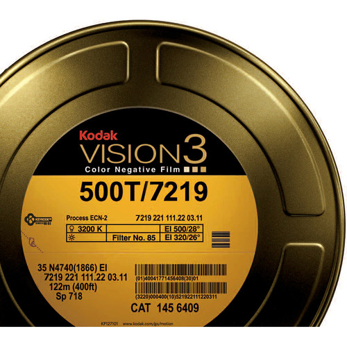

PPS : T500 is not with c41 development - but you can try it in c41 soup - but it is comparable with Portra Films - perhaps you will have to start your "highest ISO Experiment " first with Portra Films.:wink:
Sort of. It's an ECN2 film and I've done a fair bit of experimenting with these films (particularly 50D and 500T) for the purpose of printing them onto RA4. I've tried several routes, including cross processing in C41 (which sucks; the color balance was too far off to get even a halfway decent print), dramatic overexposure (3+ stops) to match the contrast requirements of RA4 and pushing. The latter, push development with ECN-2 chemistry, yields the best results, but there is significant blue-yellow crossover. Long story short: the vision 3 films are comparable to C41 films in the sense that they are both color negative films. That's about as far the comparison will go. The color palette of these ECN-2 films is fairly subdued - or it seems to, at least, until you increase the contrast during processing to match RA4 paper and then saturation is somewhere in-between Portra and middle-of-the-road films like Superia.
I find that with C41 film, underexposure by about 0.5 stops and a +1 stop push development gives a contrast (and saturation) boost that can be useful in some situations, when subject contrast is particularly low. You get increased acutance as a bonus.
As to pushing C41 by 3 stops or more: the same goes as for B&W films: you can sort of fix the contrast, but you won't get the shadow detail of a true (very-)high film speed. Push development is easy; either increase the color development time, temperature or both. A 3 stop push will require development times in the range of 8-10 minutes and it's about as far as you can go; nothing much more happens beyond a certain point of extended development. Whatever crossover there may be due to inaccuracies in the chemistry or aged film, will be amplified when cross processing. Grain will also be amplified, evidently.
Some of the things that may go wrong (lack of shadow detail, disturbed color balance) can be fixed to some extent when scanning and post processing digitally. To keep grain size in check, just shoot a larger format.

Yes I know Ecn 2 films in Ecn 2 chems vs. Ecn 2 films in c41 developer are two different pair of shoes (beside the aditional remouvable layer.)
But I just mentioned T500 because (from my point) it is the todays fastest speed film in color.
A little more "pushable" in comparison to Porta or lets better say : with a little better characteristics after max. push steps compared with Portra.
What may be caused from original Ecn 2 development - so that advantage may be lost with c41 developer. But in general both films (Vision3 / New Porta) have nearly the same excellent characteristics with or without push workflow.
50 D seams to have highest resolution wich you can to get today (pls. don't push 50D).:wondering:
But the Op will try it with Portra films for sure. I doupt in results at box speed ISO 12800/25000.
But there is no better way AS to try it ...,:pinch:!
