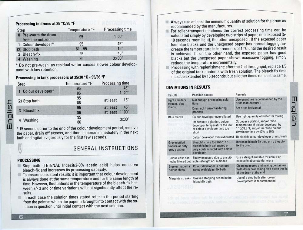

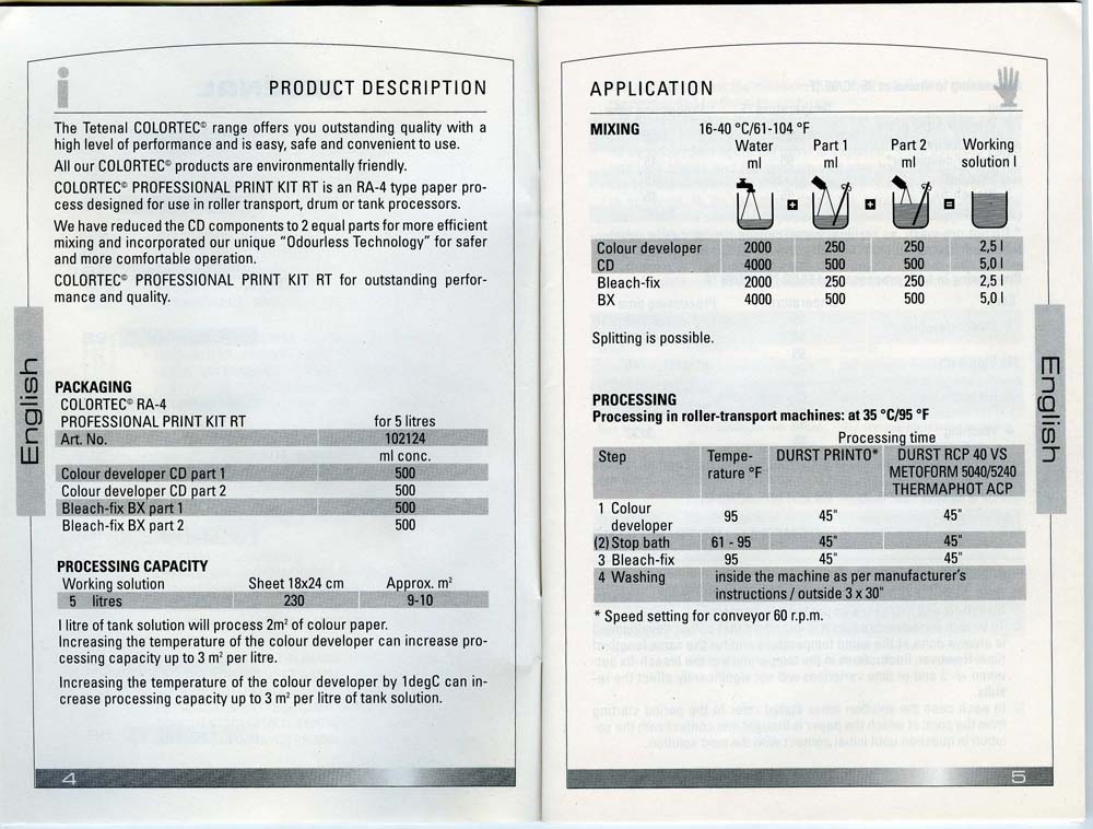

I seem to have misplaced the instructions that came with the Tetenal Colortec RA-4 kit. Unless I've missed it, Tetenal's site doesn't show a copy. Anybody got a scan, or can summarize the times/temps? Thanks.

Hi there - are these the correct instructions - they are from a current kit:
