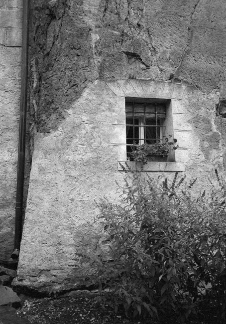

Well, I tried a roll of Delta 3200, which I developed for 6 minutes at a dilution of 1:15 -- taking the 6400 time (as I usually would for Delta 3200 exposed at 3200) and adding 25% for the intermittent rather than continuous agitation.
The tonality of the negs is fine, but they are really grainy. With a blocky, unpleasant grain that almost looks like digital noise. So I think I've overdeveloped them quite a bit.
John Bragg
Nov 29, 2005
1,039
Cornwall, UK
I would be tempted to use dilutions and times for HC-110 as an experiment, since this dev is also highly concentrated. The 1:15 would be the equivalent of Kodak HC-110 dilution A, so extrapolating this, 1:31 should equate to dilution B and 1:63 dilution H. Worth a try with reduced agitation....
Regards, John.
mcgrattan
Apr 5, 2005
505
Oxford, Engl
Looking at the couple of times I found (on the rangefinder forum) for someone using it at 1:31 they do seem pretty close to the times for HC-110 dilution B.
Thanks very much, that might be a very useful tip.
