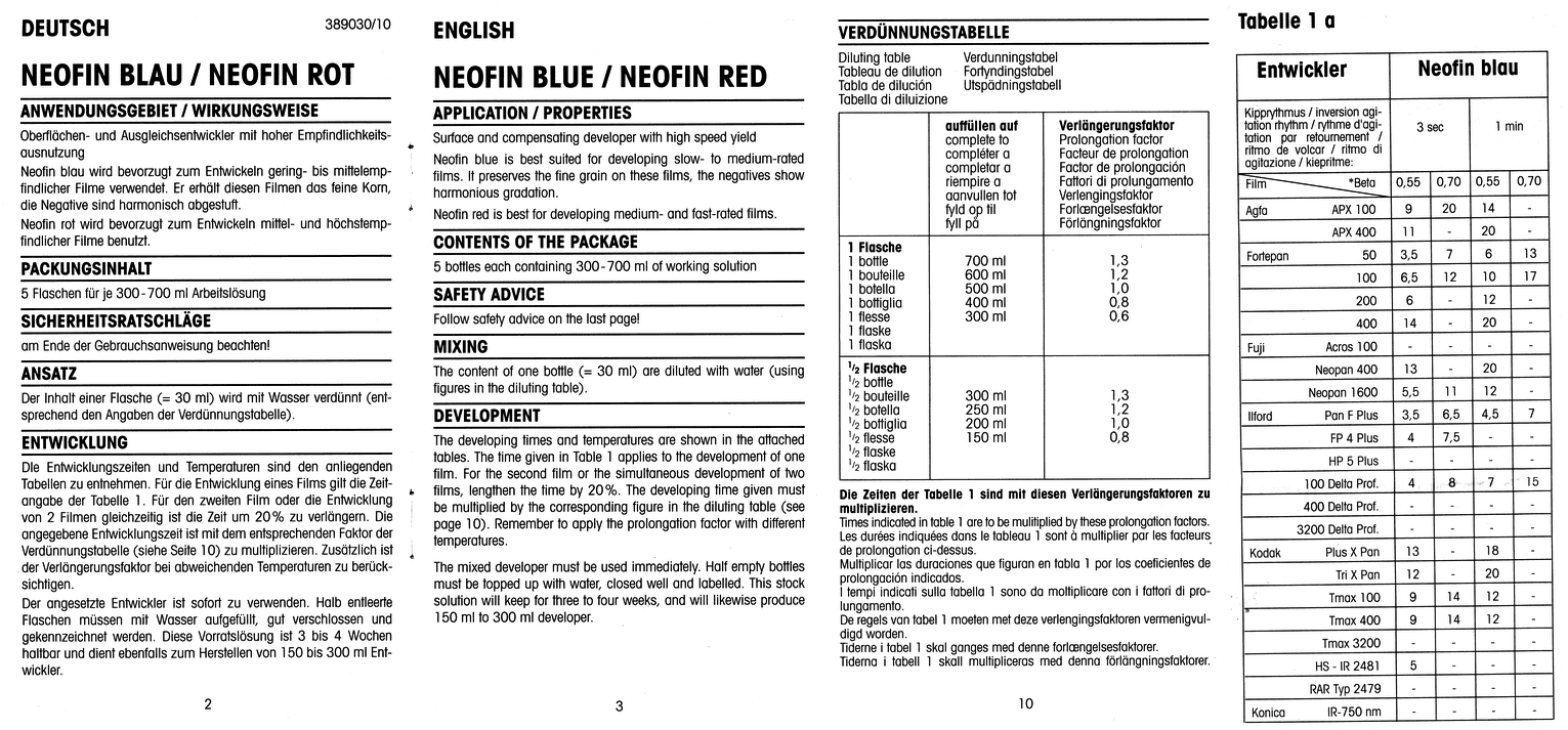

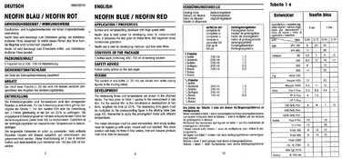

I have a lengthy document called "NEOFIN Technique" that I copied from the internet years ago; I think I found it on the website jackspcs.com -- this site appears to be defunct, and even using the Wayback Machine the links lead to an entirely different website in South Asia, I believe. This document says one vial is intended to develop one roll of film, making no mention of doing a second roll. Of course, it's your film...As an aside, the author also make reference to using Neofin to develop document film by diluting a vial in 1000cc of water and testing from there. NOW -- having said all that, I also have NEOFIN instructions as provided by Tetenal (attached) wherein Tetenal says that if you want to develop a second roll of film, go ahead and do so but remember to add 20% more time. To quote the instructions: "For the second film or simultaneous development of two films, lengthen the time by 20%." So the manufacturer certainly thinks it's OK to use one vial for two films.
In the current manual this is not expressed this way. But to use the working solution immediately. Added by the fact that for two films then a larger bath volume (= lesser concentration of the working solution) is needed, such lengthening of time results out of the concentration/time table.
