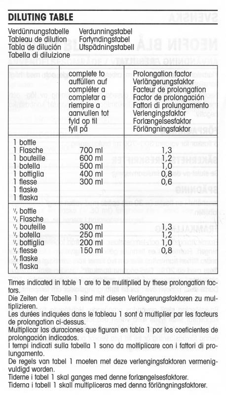

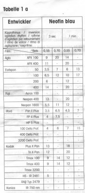

Here is the manual of Neofin Blau, for those who happen to be without. The times I tried worked out a bit long.
