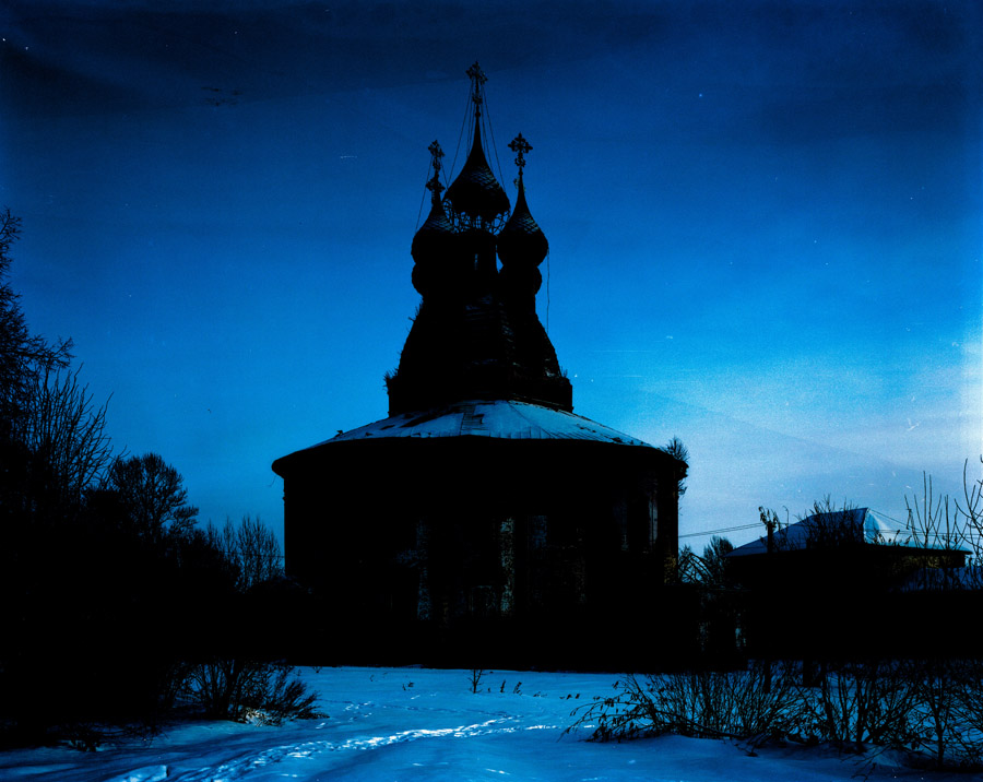

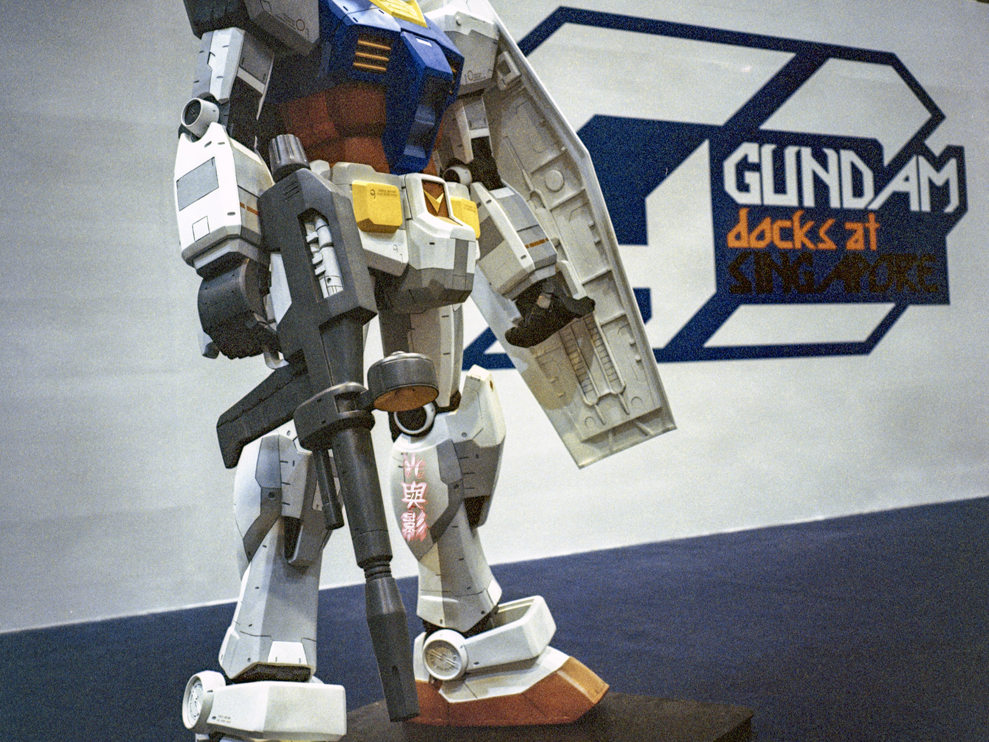

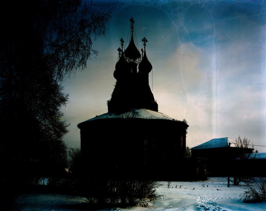

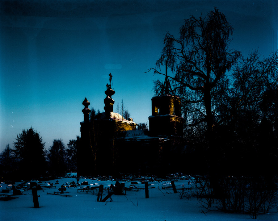

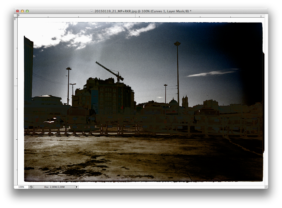

Well, I cried victory too early. Here are the results of the last processed batch.
Method:
2x30s pre-wash (at 38C)
3:45 dev time (as per instructions, 3rd re-use)
00:30 stop bath (1:9 from Kodak)
1:00 water wash
14:00 blix (I add time)
the rest as usual...
I seem to have gotten rid of the uneven development but my bubbles are still here:
Now I identify 3 issues:
1) bubbles
2) yellow fog/oxidation
3) something is happening on the edge of my negatives (related to #2?)
It's worth noting that I could only find the bubbles on 1 frame per film (I washed 4 at once). My test medium format seems quite clean except for the "road ruts" (as someone else called them) and a darkening of the right edge which might be scanner related (as in the 35mm examples, if you see a black edge by the frame, the corresponding brown burning on the frame is due to the scanner light leaking through).
I was going to try the alternative process as I see no other alternatives left (except getting my hands on a digibase kit), but after reading through the posts, it doesn't seem worth it. Though these posts were usually lacking visual examples.
What to do now?

Photo Engineer
Apr 19, 2005
29,018
Rochester, NY
Did you notice that the marks are roughly "H" shaped and are in roughly the same place on every picture? Since you call these screen shots, I have to assume that those defects are due to reflection from the screen, otherwise they are some sort of light leak. IDK.
Compare 1, 2 and 3 for "H" shape in upper left and 4 and 5 for a line in the lower right. These are dark in the negative and thus could even be light leak in the camera due to the repetitive nature if from different frames.
Please clarify the source of the images more.

Hi PE,
These are screenshots, but not taking with a camera off the screen
As for light leaks: these are from 3 cameras. One Rolleiflex and two Leica M. The negatives show absolutely no indication of light leak. As I said earlier, these things are impossible to see with the naked eye.
Also there are only three pictures: a processed and not processed for the 35mm and a processed for medium format.
I noticed I posted one in double, I will try to remove it.
m.

Photo Engineer
Apr 19, 2005
29,018
Rochester, NY
Lets look at two images here:
Do you see the "H" in the one with the crane almost pointing to the bar in the "H" which is at an angle to the frame? In the other photo, in the lower right, do you see the regular bar with sharp edges at an angle?
These are very difficult to get my means of processing except by bromide drag through sprocket holes or by a spill of liquid, but in the latter case, the spill generally has a head and tail.
So, this might be light fog as you load the film.
These differ from those in the OP as well.

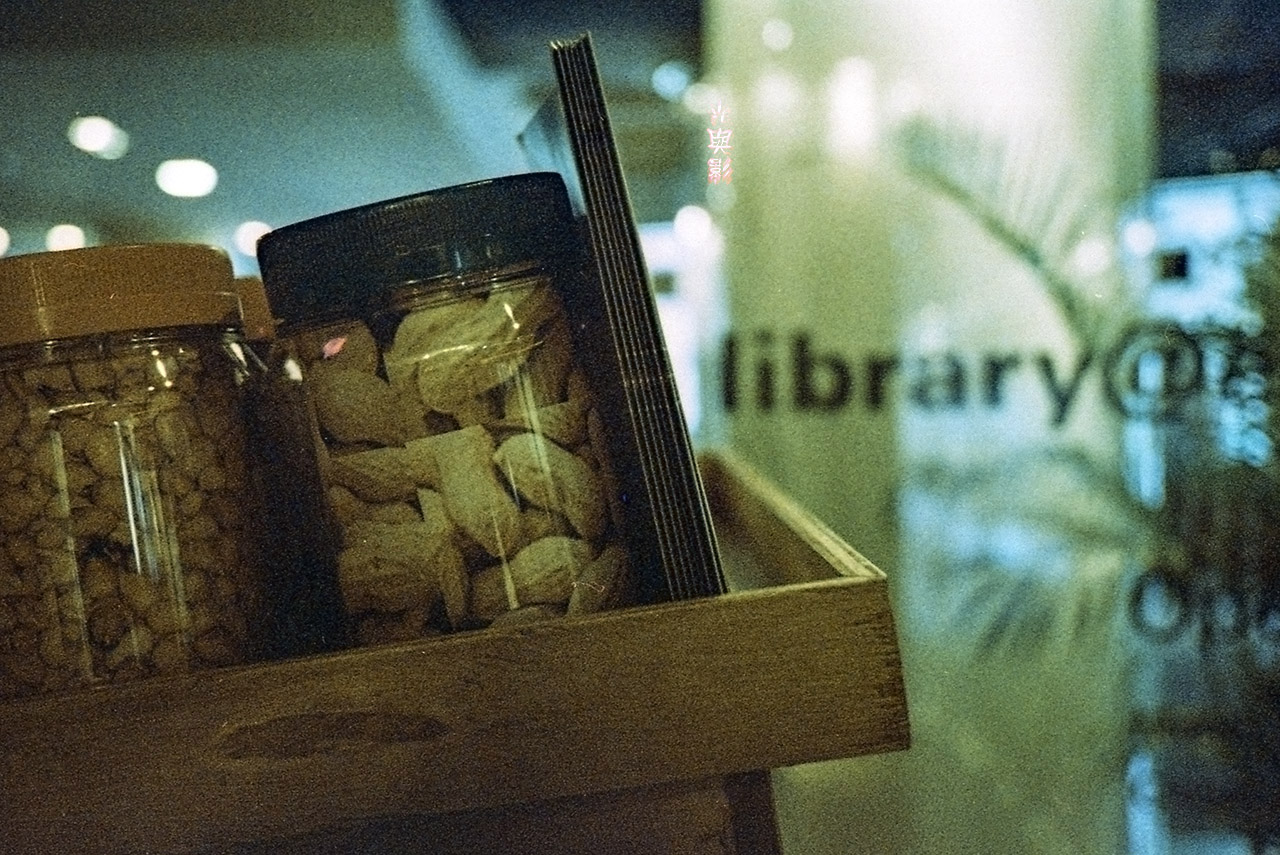

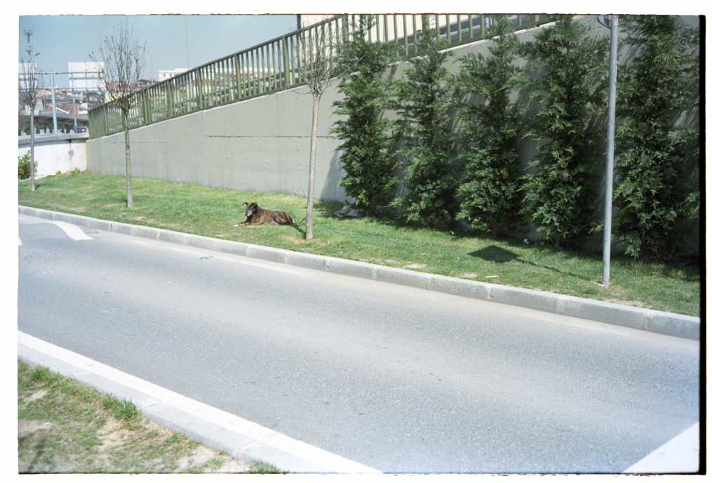

Just found these images, trying to check your hypothesis:
A "normal" one, no visible defects I can see (except this yellowness)
And now one with something I've never noticed before: an airbell (next to what you assume are light fogging)
does it help narrow a diagnostic?
Sirius Glass
Jan 18, 2007
50,411
Southern California
The second one may not have been put in the developer evenly [all at one time].
Photo Engineer
Apr 19, 2005
29,018
Rochester, NY
On the pictures that I reposted, I suggested light fog due to regularity or bromide drag. These latest samples look entirely different, but the top picture is definitely suggestive of bromide drag and the bottom picture is suggestive of uneven wetting with water before development or uneven coverage with developer when you pour it it.
These two sets do not look like they can be equated. There is some mismatch here to me.

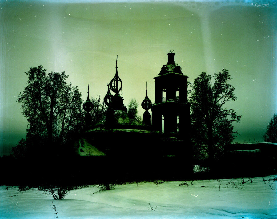

Hi
I am wondering if you managed to resolve this issue in the end.
I seem to have similar issues with large format negatives developed by a lab using Jobo rotary processor, and the lab technicians do not seem to have a solution so far.
The negatives come out with foam / bubble-like patterns mostly visible in the lighter areas of the negative, especially along the longer side and with what looks like flow streaks across the shorter dimension. There are also steps in density with pronounced diagonal edges. The attached examples have digitally increased contrast but you can see the defects on on normal scans. They do not pop out straight away, but you have no problem finding them once you know that they are there.

Photo Engineer
Apr 19, 2005
29,018
Rochester, NY
This looks like they used too little solution, too slow a rotation or may need a stop bath. All three of these can cause similar problems alone or together.

I have had the foam bubble issue before.
I think it may have been related to using stabiliser in the tank, and it not quite being washed enough after use and foams up the next time the tank/reel is used.
I have stopped using stabiliser in the tank now, I take the film off the roll and use the stab in a different container.
I've not seen the bubbles since.
But that might be just down to coincidence. I'm no expert and am expecting somebody far more knowledgable to say why it's not the stabiliser... ;-)
Edit: Didn't see PE's reply above. I haven't used a stop bath with C-41 so that could be a reason. My Jobo has one speed so there's nothing I can do about that! ;-)
p_antonov
Mar 31, 2017
Moscow, Russia
Photo Engineer, klownshed, thanks!
What would be the way for the insufficient solution volume to cause it? The foam is mostly along the longer edge of the sheet, which should be vertical during the development, so I would expect that the rotation should take care of that?
I do not think they are using stop bath, but I will see if they can start using it. I understand it is not a compulsory step in C-41 development?
Is there a speed setting that you would recommend to avoid this, or is it more trial and error? I will check what speed they use.
My first thought was of the tank / reel being contaminated with surfactant as I had had a similar issue with my home B&W development. The lab technician however dismissed the suggestion, as the tank is constantly rotating unlike with home B&W.
Also, can it be the case that the next solution is not poured in quickly enough after the developer is out of the tank and the remainder is left foaming on the surface? I.e. a combination of stabiliser contamination + slow speed + lack of stop bath?
Photo Engineer
Apr 19, 2005
29,018
Rochester, NY
Insufficient volume leads to "sloshing" or "churning" of the developer causing a sort of foaming action. This causes bubbles. It also causes streaks due to slow coverage of solution. A prewet can help greatly in fixing this if they think the volume and speed are ok.
This is most likely.
Speed can be helped by going up one step and see if it helps.
A stop bath would only be a last resort if all else fails such as more volume and faster pouring.
I have never ever seen surfactant cause this, but then I wash my tanks and reels very well with hot water.

p_antonov
Mar 31, 2017
Moscow, Russia
Thanks a lot. I will talk to the lab people and see what they have to say. Pre-wetting was too a suggestion from someone with whom I discussed the issue earlier.
