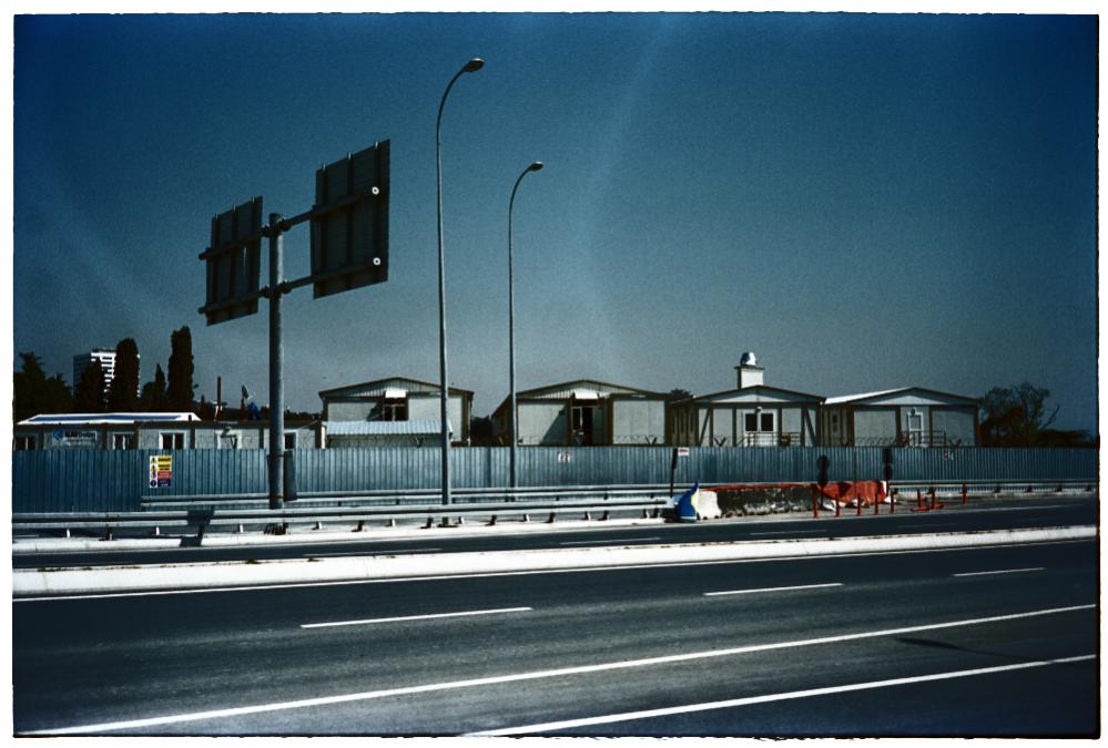

Hello,
I've been searching for some answers to my new endeavour: color developing (soon to be followed by RA-4 printing) and found some useful information but nothing that answered my questions directly. Let's start with the most aggravating issue:
Please have a look at this picture. I modified in Photoshop to try to bring out the issue more clearly. As you can see there are some "foam" looking density variations. These only appear on some frames and not all. I have noticed it in both 35mm and medium format, but as I said, they are not on all frames of the same film (as far as I have noticed).
attachment.php
Here is the processing for this image:
5mn dry pre heat as per JOBO instructions,
Jobo CPP2 on "P" agitation setting,
38C @ 3:15,
Stabiliser: 2 drops in 700ml of water, gentle hand agitation,
Hung to dry at room temperature.
These are very hard to see with the naked eye, but on this particular negative I could see it. There are no residues on either side of the negative.
Tetenal customer service did not get back to me, but a very nice gentleman from Jobo helped me. I am now looking for your opinion and experiences as to what you think causes this.

Just to be sure: can you tell us how much chemistry you used in one dev run, and which film tank you used?

The only factor that determines change in development time is the number of film sheets or rolls as described in the manual. AFAIK speed does not need to enter into this. But, you may want to check the Kodak web site. They have a good description of the need for compensation.
Ok, now, as for your problem, I think you may fix it by using a pre wet of 1' at 100F. Also, that looks like severe foaming that can be eradicated by a prewet or by tweaking the amount of developer used.
I hope that you used the rest of the process solutions. They are not mentioned. But just in case, it is often good to use a stop bath right after the development step. This stop is usually 1-2% Acetic Acid.

Hi,
thanks for you answer. I did not explain myself properly. I was not referring to the development times but to the amount of film you can develop. All c41 developers seem to allow for less 400asa film than 200asa for the same volume. So the question was, how do you compensate when dealing with mixed asa workflow?
Yes, the rest of the process solution were used of course :D I follow the instructions to the letter. When you say amount of developer tweaking, are you thinking more or less? As I said, I use 1L bottles, though by the end (after 16 films) I must have around 800ml of developer in the bottle.
The Jobo fellow's recommendation were to increase agitation and skip (dry) pre-heating. His assumption was that maybe humidity during the pre-heating phase was the culprit.
To me the foam-like structure is quite striking. I wonder if while filling it up (cpp2 with lift) I'm not creating this foam?

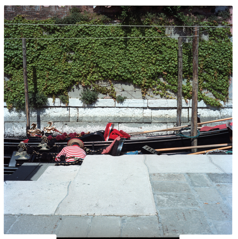

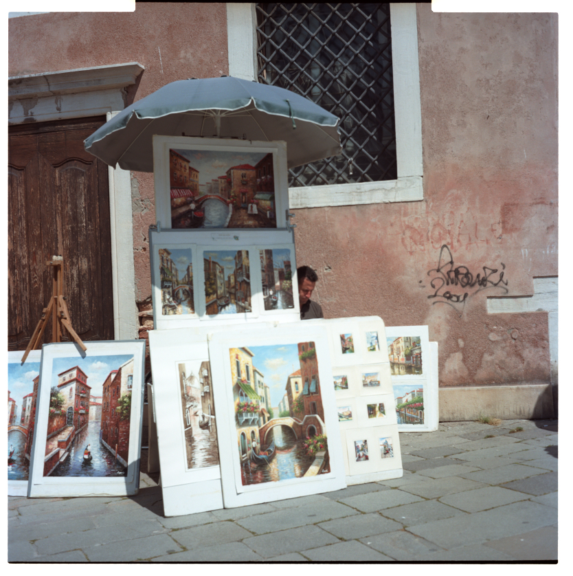

update:
after getting some slight bubble stuff still, I followed PE instruction to the letter. It came out without bubbles (the first temp/water wash comes out with bubbles, so that might explain my first problem) but I feel there is some uneven development/color.
Sequence:
1mn water wash
3:15mn developer
1:30mn stop (sprint blok 1:9 dilution)
water wash
4mn blix
wash wash wash
1mn stab
Two example from the last film:
attachment.php
attachment.php
I seem to see some discolouration (blue) in the corners... Or is it just my eyes/screen? Only medium format seem to be problematic, 35mm has no issues (unless developed alongside a 120 film)...
Is this optimal result, or have I just exchange one set of issues for another?

It is difficult to see the non-uniformity issues in these scenes as they are so "busy" with objects of different types. They look pretty good to me.
What I do see is that your blix time is very short. Usually a bleach and a fix for C41 can require anywhere from 6 - 8 minutes. You might look into this. Also, when I see good negs from 35 mm and a hint of a problem with 120 or larger, I look at solution quantity and amount of solution used. If you use too little, foaming can take place at the corners, and even if you use enough, high agitation can cause foaming along one edge.

Yes, it think the "business" hide a lot of "defects" in my self developed rolls. About this one in particular, I cannot really see it, but I can feel some uneasiness. I developed another 120 today, this time with 2 washes before developer and no stop bath. The idea being that the stuff that washes out from 120 might create the bubbles that overdevelop parts of my film while I empty the developer.

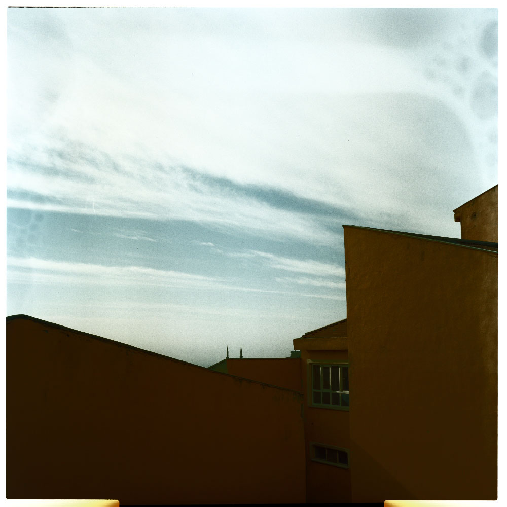

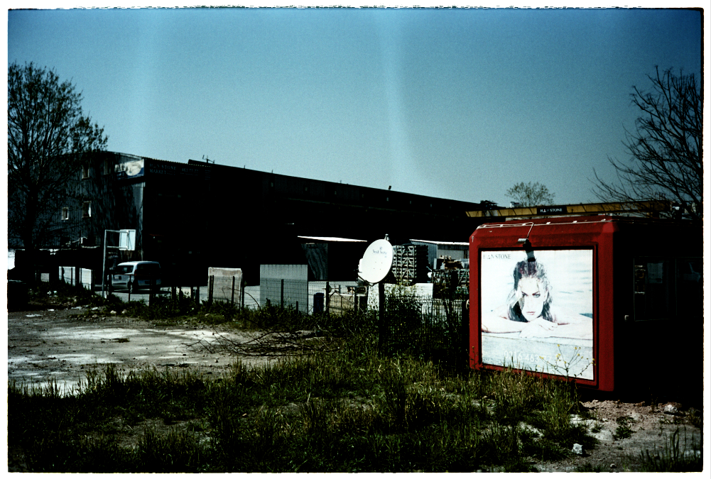

Here is another thought. I developed 4 35mm yesterday and only one film came out with something very similar but "blurry" :
attachment.php
attachment.php
And then a new issue:
attachment.php
So my new thought is this. It's still the stab. I'm not running it through the machine anymore, all I do is dunk the reel in the end and that's it. And I think this might still be a problem. I notice foam on the edges on medium format, and in the above example this was on only one film out of four processed together. So I'm guessing that one reel still had some stab residues on it.
I brought all my reels home and will scrub them in hot water to try to clean them as best as possible.

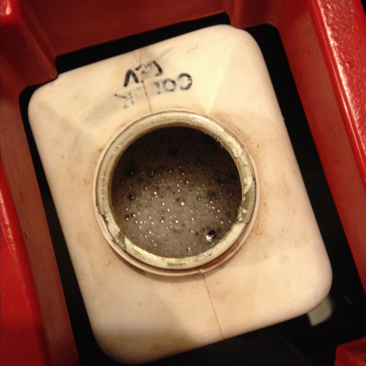

Also, is this too foamy?
attachment.php
It's my developer after pouring it back.

The answer is not in the stabilizer, provided you clean your used reels well.
The third picture shows distinct bromide drag which comes from incorrect agitation. The swirls on the first two are probably from bad agitation as well, or bad pouring of the developer or blix. If you pour the developer or blix in in an uneven fashion, then you run the risk of streaks like this.
