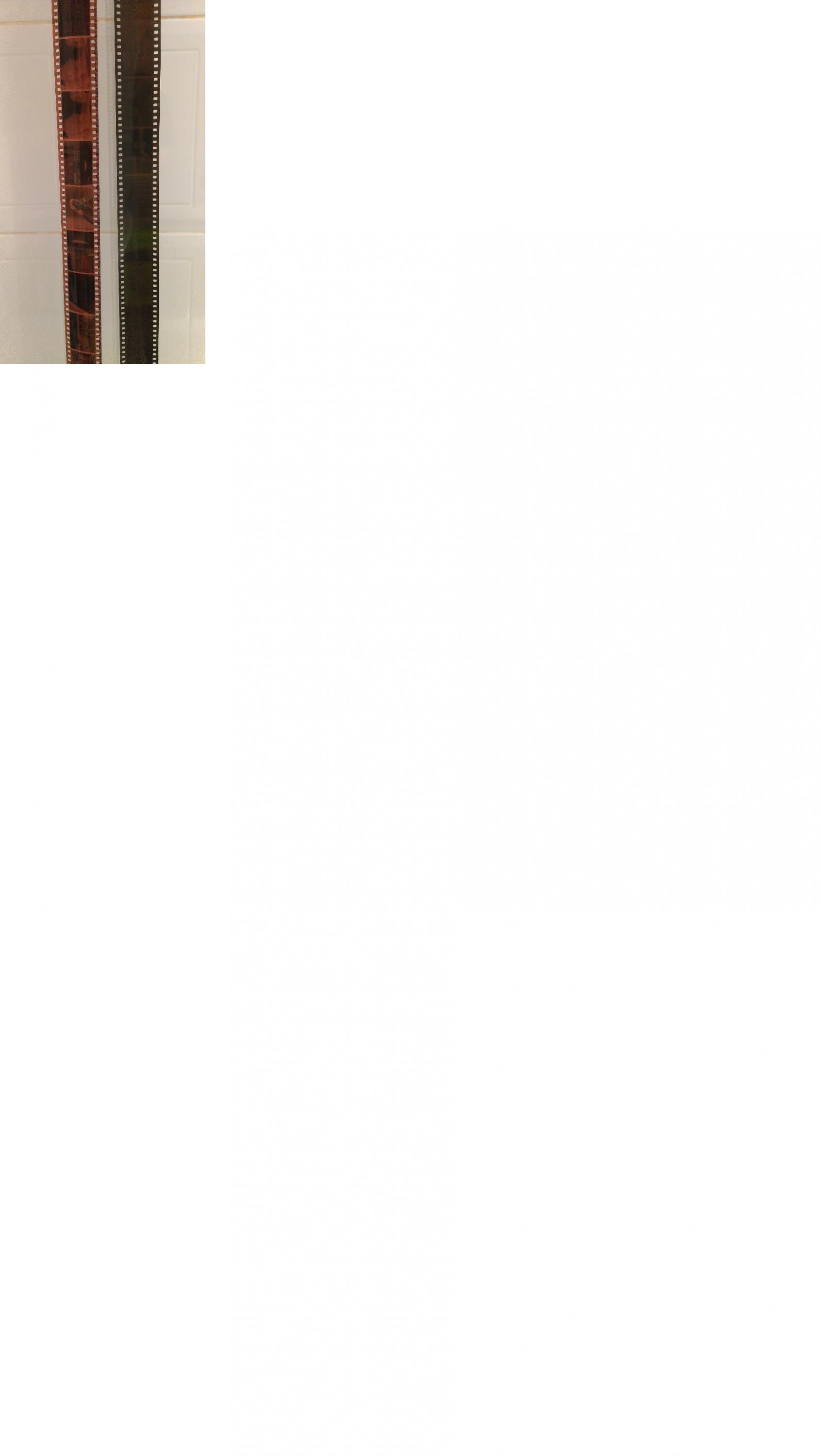

Welcome. Pictures help -- especially if you can scan both strips alongside each other. Given what we know, if one film came out good and the other bad, and you processed them together, one has to suspect the film -- that it was expired, stored poorly, exposed to light, or something else.

I've attached a photo of the negatives. sorry about the quality (I don't have a scanner, so they're a photo on my phone.) They do have a couple of reflections, but you can see the quality difference.
I processed another couple of rolls today and they're still quite dark (but not this bad).

Can you confirm that these two test strips were processed in the same drum in the same dev run?
Please interpret the silence in this thread not as lack of interest, but as complete puzzlement with your results on our side.

Film outdated? If the film was fresh, is it possible that the film was fogged (exposed to any form of light) while being loaded in the tank or thereafter?

They were both the same films, bought at the same time and processed in the same tank in the same development run with fresh chemicals. I loaded the tanks at the same time in a light tight room. Even Tetenal themselves have no answer.
I processed two more films yesterday and they have both turned out dark, but nowhere near as dark. Although these 2 from this second run were films I shot about 6 years ago and have just found.

Is it possible that the dark roll was loaded in the top reel of the tank, and that the reel somehow moved during development such that the chemicals did not submerge the film properly during bleach/fix/blix?
Some people use a rubber band that they wrap tightly around the center column of the Paterson tank, to lock down the reels and prevent them from moving up or down, in and out of the chemistry. I don't know how much room is above the 600ml chemistry line of a 2-reel Paterson tank.
It seems improbable that the chemistry would have done it. Which leaves either the film or the way it was processed. Since the film was from the same batch, the logical approach would be to suspect the process. Or monsters.

Polyglot&LikeAPolaroid: Mr. P said he rebleached with no change in results - this would speak against poor bleaching. The images do look fogged to me, but I am lost for explanations how this could happen. Most common fog (from light leaks, chemical impurities, ...) would be either very inhomogeneous, or it would have affected both rolls in the same way.

I wonder if they were shot in the same camera. Perhaps the darker roll got exposed to heat somehow, which fogged it? Or maybe exposed to light while in camera somehow?
The sources for fogging are: chemical, heat, light, cosmic radiation. Am I missing any source?

Two 35mm reels in a two reel Paterson tank with 600ml of solution (my own procedure) don't suggest coverage problems to me. An actual scan would better reveal (or rule out) uneven development, but both films look uniformly and fully processed. I still think the culprit is the film itself -- expired, fogged, poorly stored, or some such.
