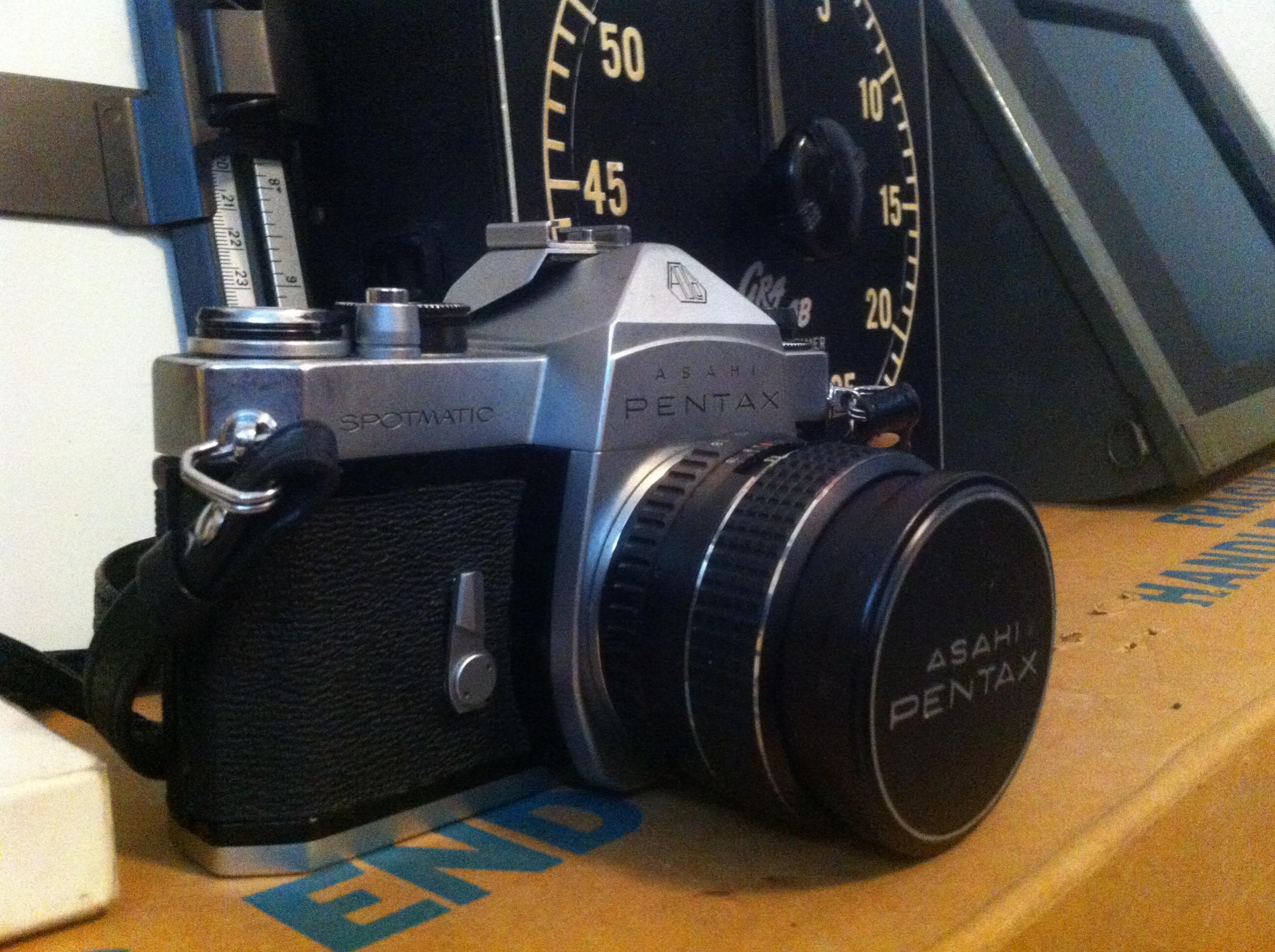

Recently CLA'd Spotmatic (there was a url link here which no longer exists). I've got the SMC 1.8 55mm Takumar on it and I have to say…I love it.
attachment.php
A few choice shots from the roll of Ilford HP5 @800
Timed shutter with a high-speed camera as best could tell for the slower speeds, and metered all my shots, and seems to be shooting well. I want to take it outdoors and get some nice fall shots—I've got some Superia loaded in it now just in time for autumn.
It's leaps and bounds above my previous 35mm, and it's all mechanical, which I prefer. I had an OM-1n but it's been in the shop for literally 2 years with no update (probably an obscure part), so this one goes with me almost everywhere.
I saw a few Spotmatic posts dated 2014, so I figured I'd not necro those and start a new one. Anyone have experience with a nice wide or portrait length lens?

Congratulations, I'm a great fan of spotmatics.. for portraits there are the excellent (and expensive) Takumar 85mm f1.8 and 1.9, while as wide the 35mm f2 is great and also the 28mm f3.5 has a good reputation.
You can't go wrong with Takumars IMO.

I bought my first spotmatic in 1967, still have it, meter is accurate, shutter spot on, last had it serviced in the 90s. Once or twice a year I take it for walk. If like it and plan to keep it for the long haul buy a second body for parts.
I have the 85 .18 and 105 2.8, I prefer the 105, the 120 is somewhat rare one of the only Pentax M42 I don't have. For wide the 28 3.5 is very sharp, need the lens hood for it. The 35mm is also very sharp, while the 24mm is good, my example has never really impressed me. There are many excellent M42 lens to chose from hard to know where to start. Yashica, Mamyia, Zeiss, Fuji, Roich, and Cosina all made good to excellent lens. The Pentax forum has a nice listing and user reviews of various M42 lens.
