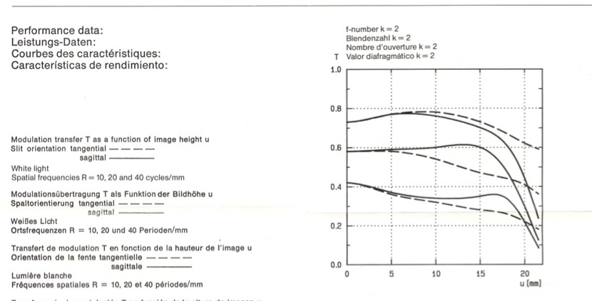

I think many lenses from the "heyday" have been surpassed. I recall one of the first lenses to be designed with MTF in mind was the Zeiss 28/2.0. Though, that was designed back in the 1980s. I cherished that lens (even bought a second) but my modern Nikkor AF 28/1.8 might be better (if you can stand the plastic).
(Nikkor top, Zeiss bottom; only look at upper most curve, 10 cycles. Other lines don't match up, 20,30, 40, etc).
