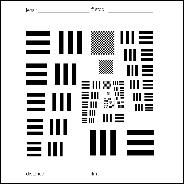

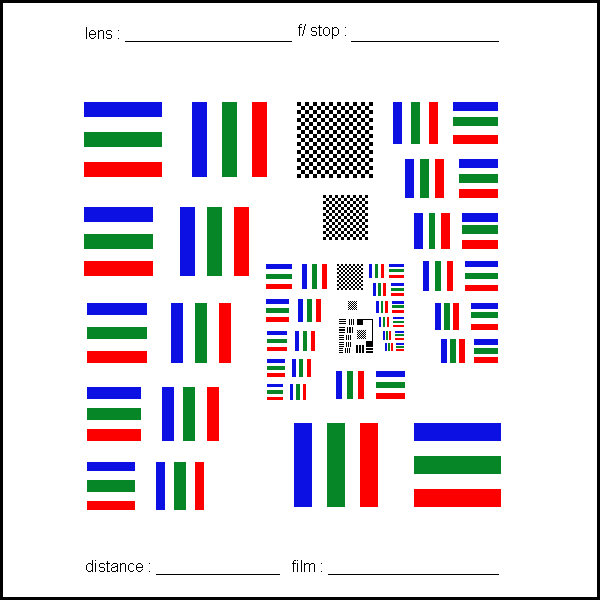

phfitz
Dec 26, 2004
539
Hi there,
waynecrider: 2 are attached, print up all you want. How you measure is up to you.
Have fun with it.
