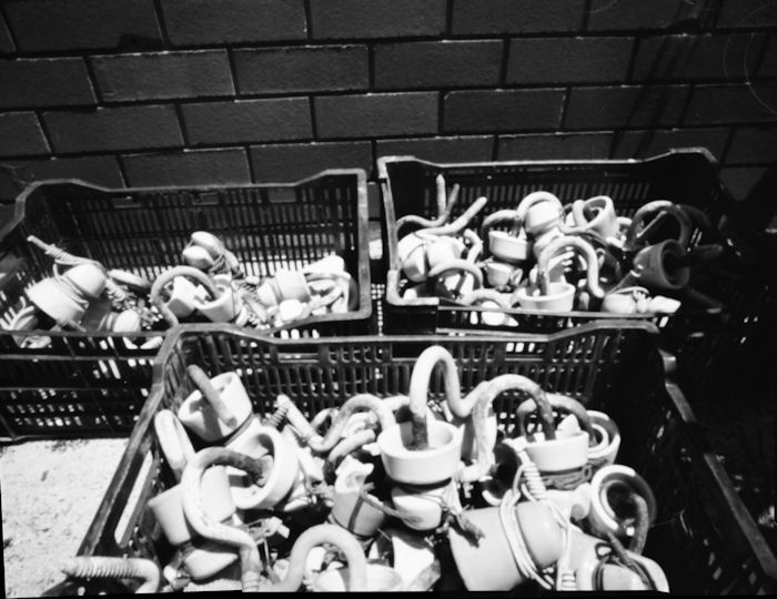

Sharpness test with 500micron pinhole
NOT IR film Foma 100 was use for this test
Wasn't the best choice of subject or distance, the brick wall looks like I'm on the right track.
