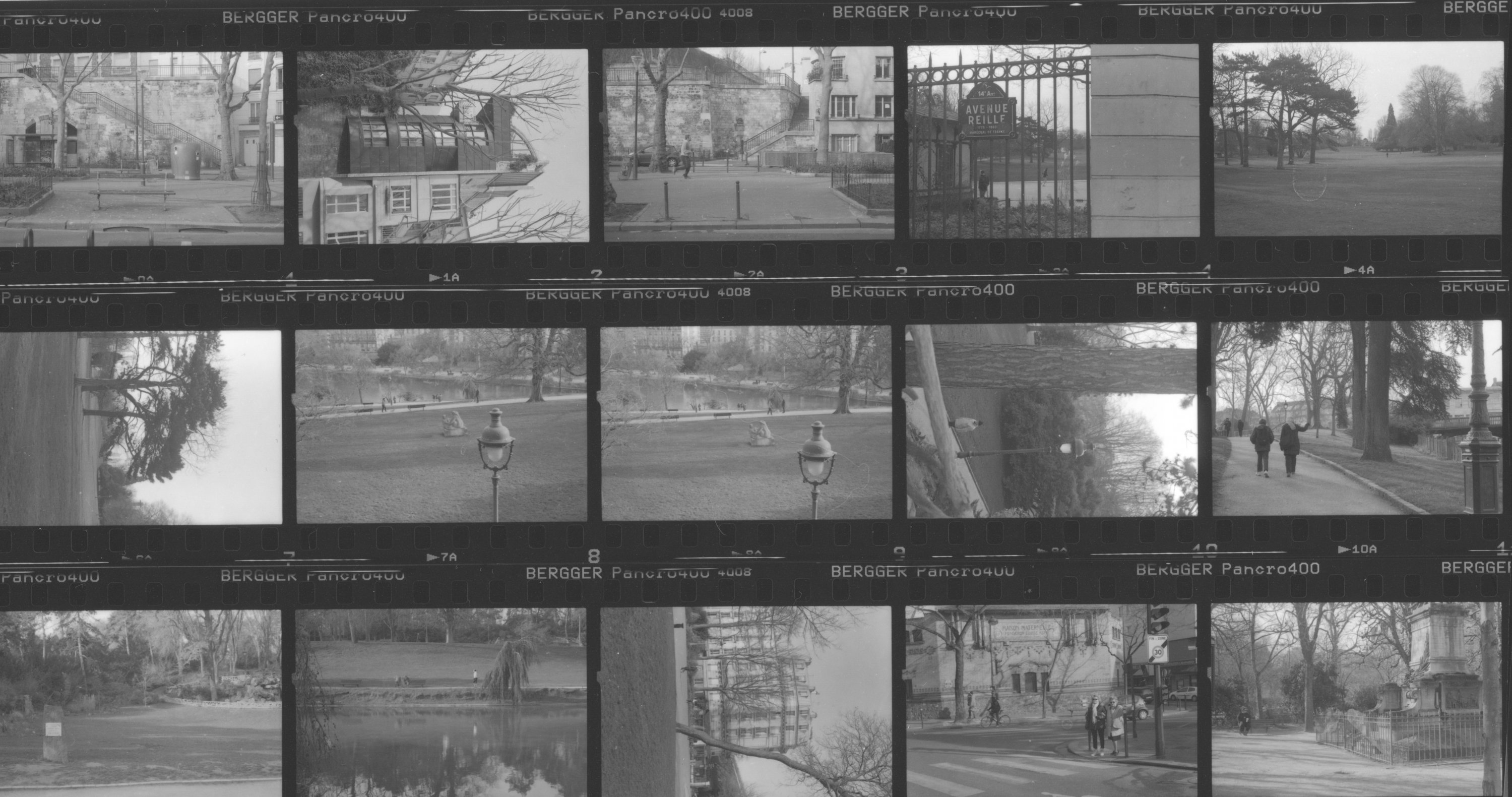

Just for completeness, here is a scan of a part of a contact print of the bergger-pancro400 film I mentioned at the start of the thread which I made this evening in the darkroom at work (I'm lucky...). I tried to expose enough so the film was as dark as the sprocket holes, but that's doesn't seem to be the case on the scan. There are no adjustments on contrast for the scan. Well, it seems to be fine!
Yes I admit I take lots of photographs of trees :smile: but it was a 'test roll' :smile:.
rpavich
Aug 24, 2015
1,520
West virginia, USA
I took this contact sheet into lightroom and set the black point of the clear edges of the negs to match the black of the sprocket holes and they still looked really good, not underexposed at all. Nicely done.
