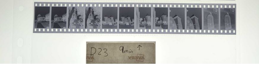

Start with a high-level shot of all the negatives:

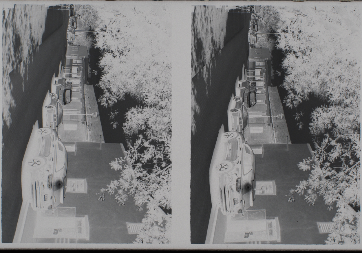

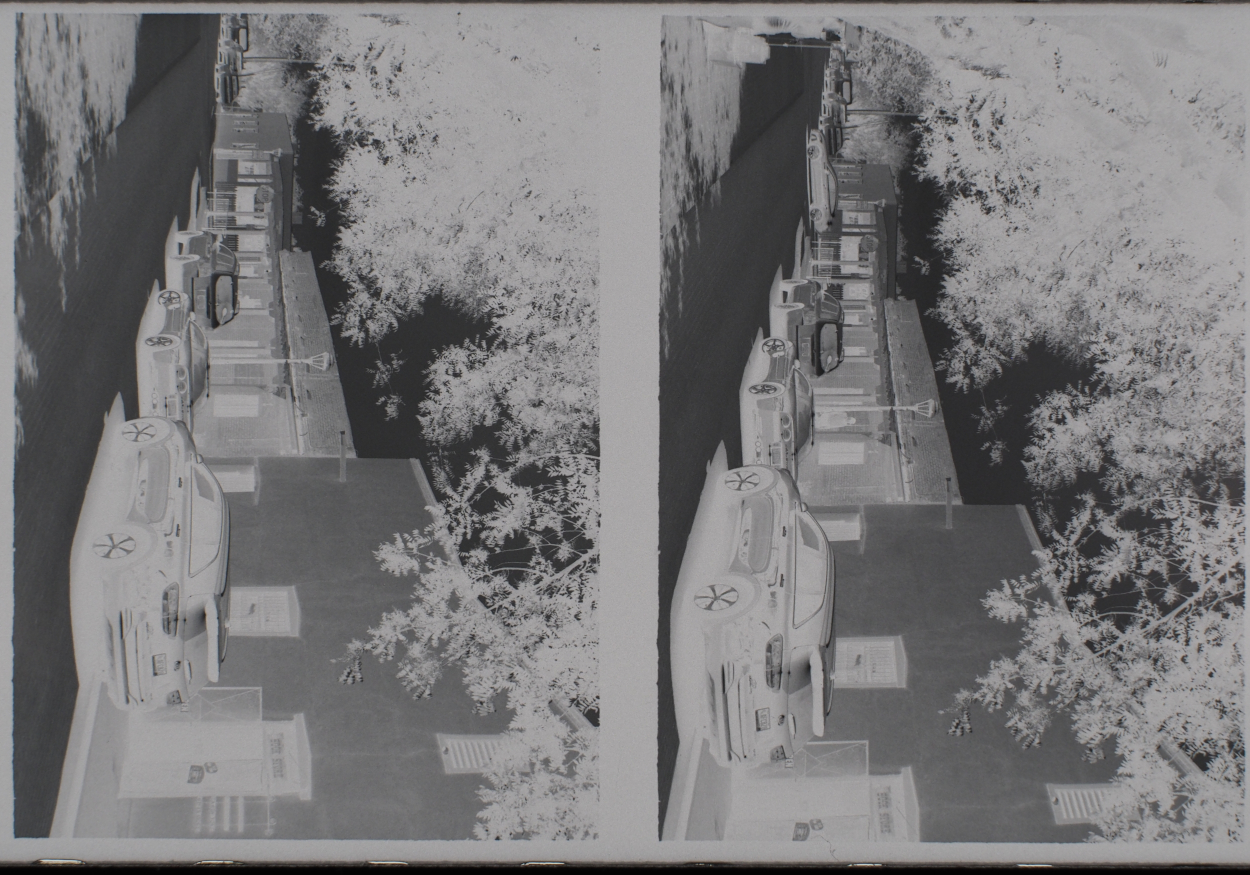

Now the scans of two sample scenes:
1) D23 for 6min --- EI 250 (left) + EI 200 (right)
2) D23 for 7.5min --- EI 250 (left) + EI 200 (right)
3) D23 for 9min --- EI 250 (left) + EI 200 (right)

Looking at the shadows, I'd rather use the El 200 negs. For contrasty scenes El 100 can sometimes be nice.
And I would probably develop for at least 7:30 min. But that depends on what the negs would be used for. (For alt processes 15 min would be better. 18x24 mm contact prints! :smile:)

I'm seeing a lot of variability on your exposures within the same negative strip, so it's much harder to judge development until each frame is exposed identically.
In the first photo of all the negatives, notice how the bottom strip has the left images quite dense and the right images fairly light?
I'd want to work on metering technique to get the resulting densities on the negative consistent frame to frame. Once you have achieved that, then look at adjusting development to bring the density/contrast to where you want it.
I hope I'm not being too thick-headed, but I'm not seeing it. I actually think that the left images are light and the right ones are dense, which is what you'd expect from the fact that the left images were shot at EI 250 and the right ones at EI 200.
Here's a zoom-in to the bottom strip:
Am I just going blind? I swear I think the ones on the right are denser... "denser" means "darker", right?... more silver.
Well, these are not consistent because I as intentionally exposing them differently in order to test which EI looks best. My metering technique is to point the camera and pray that the internal light meter does the right thing 🙂.
