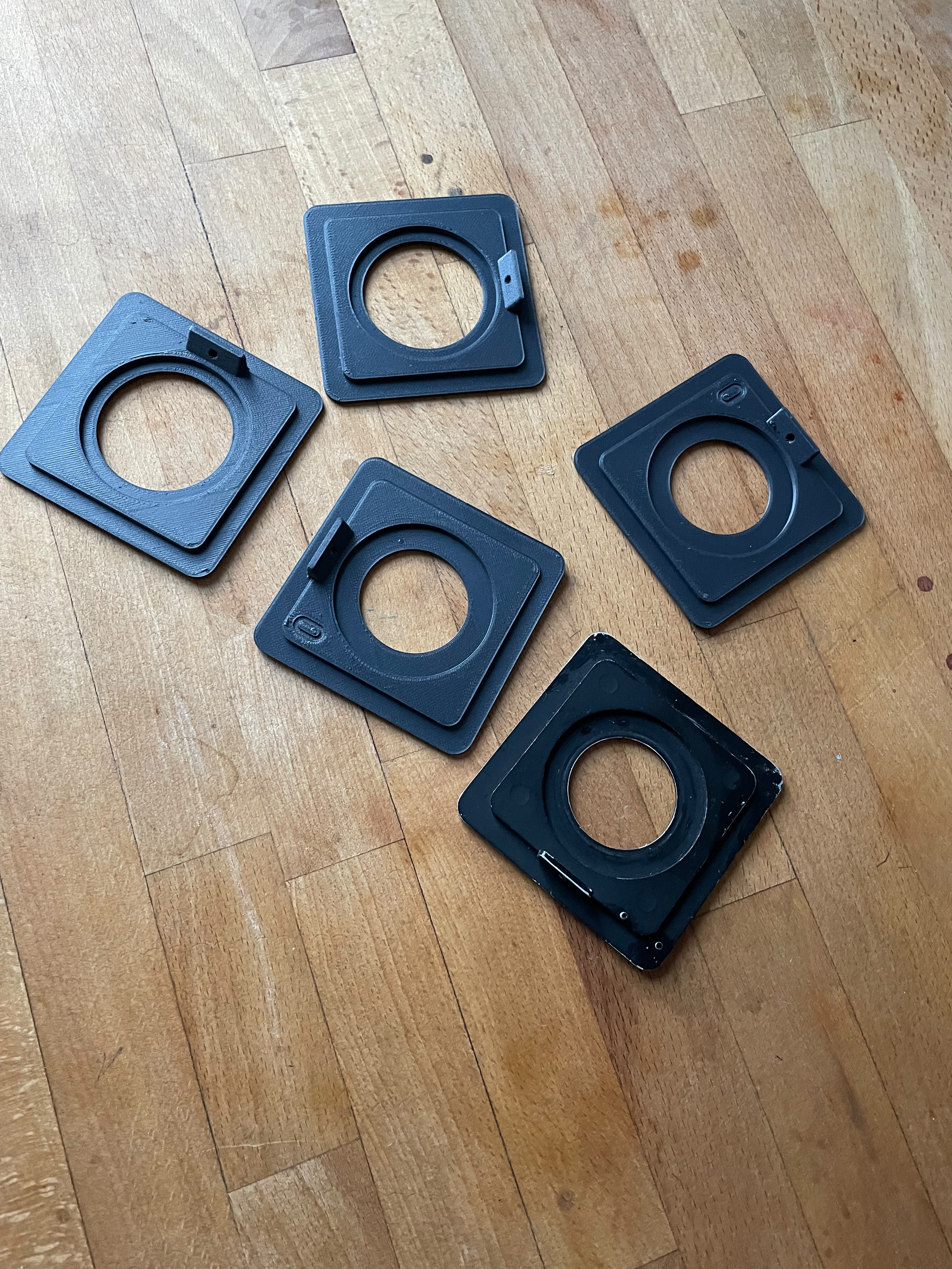

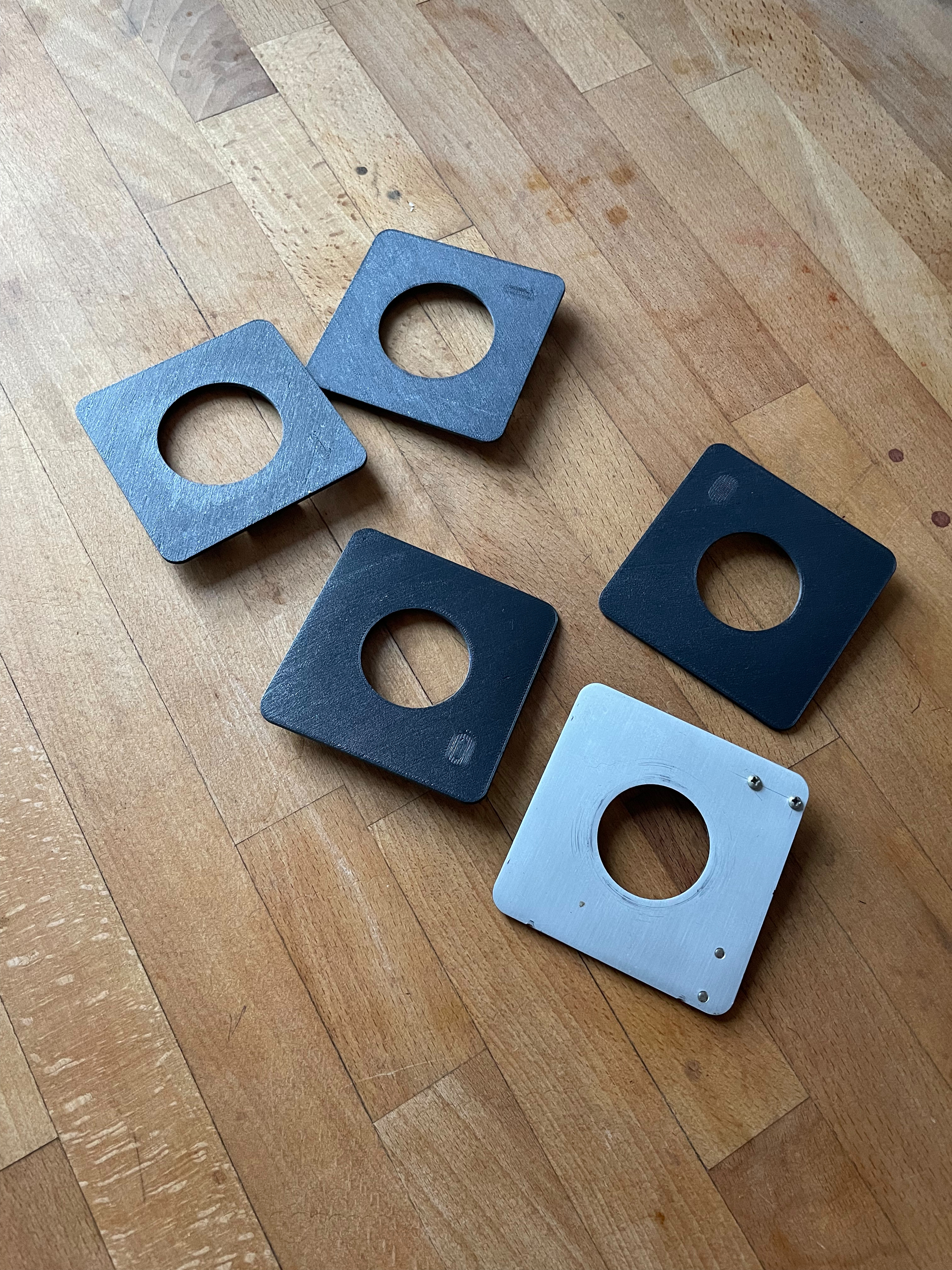

Hi PhotoTrio folks! I'm a long time reader but I think this is my first post. Abe Fettig here. I'm a film photography enthusiast and lead developer of the FilmLab app. I was recently feeling sad about the difficulty of finding lens boards for the Busch Pressman Model D (a great little 4x5, lightweight and solidly built with a rotating back). The original boards are impossible to find (unless you buy a whole camera), and there are a few handmade and 3D printed boards floating around but they require shipping from outside the US or don't seem that well made. So I asked the good folks at Negative Supply if they could help design and make some new 3D printed boards. And they did! Here are some photos of the first batch (with an original aluminum board for comparison):
They work great on my Model D, but I'd like to get some feedback from other people using various shutters and lenses before we finalize the design. So if you have a Model D, and would be able to test out one of these boards in the next week or two, please get in touch! Since I'm new here I'm not sure if DMs will work, but you can email me at abe@developandfix.com.

I have made one or two boards myself. The thickness of the board is important but the location of the hole is most important.
The tapered locking pin needs to pull the lens towards the body slightly rather than just holding the board in place.
