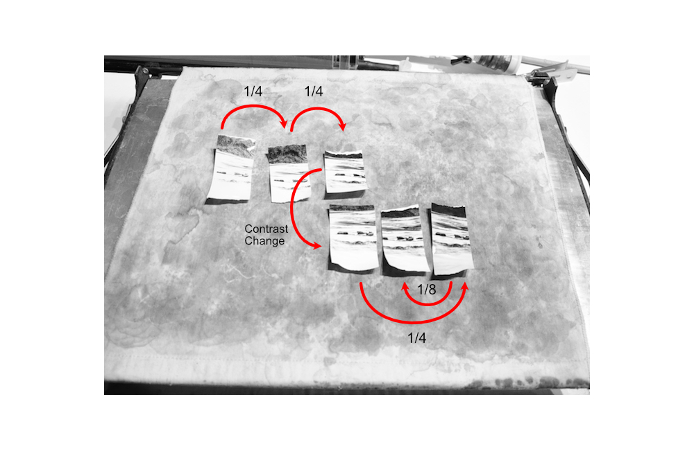

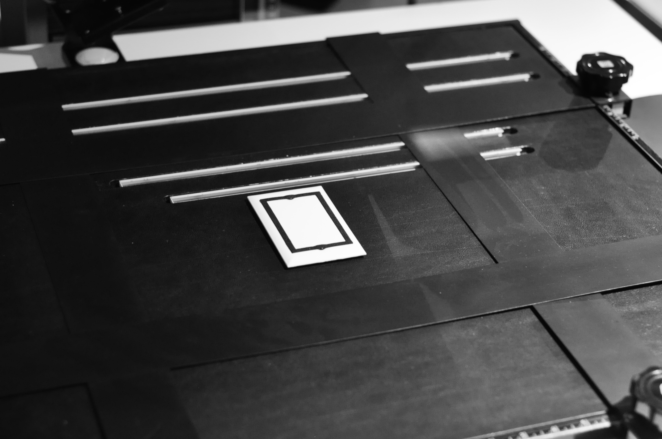

Write these down on or near the calculator:
1/2 = one-half stop = 1.4 multiplied or divided the initial time
1/3 = one-third stop = 1.26 multiplied or divided the initial time
1/4 = one-quarter stop = 1.19 multiplied or divided the initial time, etc.
The way I do it, there is no advantage to exposing the strips ahead of time, because the next step isn't known until the first one is dry.
The little white frame below lets me keep the position of the little pieces consistent.
After this I make a full print, and I will dodge and burn it from the start. I carefully examine the projected image with the lens open and all the lights in the room off. With years of experience one can get a good idea of how it needs to be controlled. Otherwise, when starting out, make a straight print first, then dodge/burn based on how that looks.
In this example the negative was 'easy to print' with only six initial exposures. With difficult negatives, I'll spend the entire darkroom session working up sections of the print before a single full sheet is ready to be exposed.

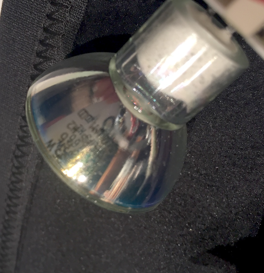

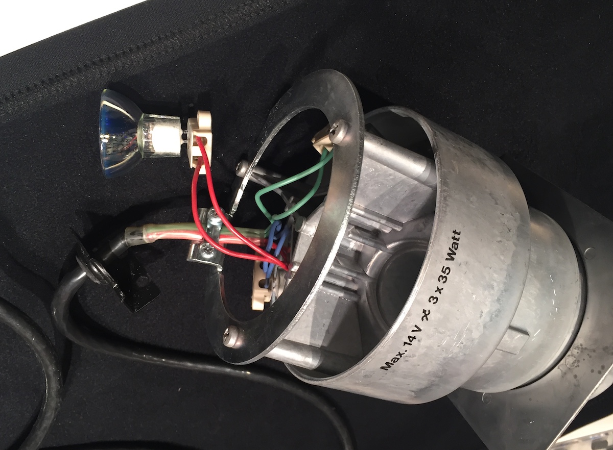

Personally I find my PCS150 low powered. I have new bulbs to go in to see if that will help, but have not installed them yet. The bulbs are hard to come by BTW, they are not standard MR16.
