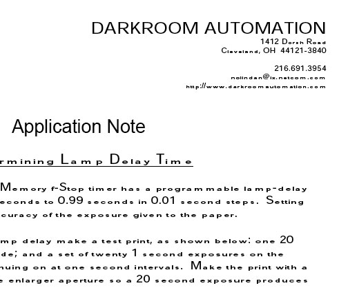

I like that. Very good technical note. It's a keeper, but the type face... ?

"Swiss721 LtEx BT", Arial-like. What is showing up at your end?
A very stylish type face with huge capitals and extremely small lower-case letters. Attached is a screen shot.

Nicholas - the pdf looks like Ralph's does on my computer. It maybe Arial like, but it's not Arial. I think it's the extended font and the extra spacing in the words that make it look funky. Like something from Star Trek. That's fine for labelling Turbolifts and Jeffries Tubes, but it's hard to read your article that way.
Nicholas - on my screen it looks like Ralph's screen-shot too and is hard to read. Have you ticked the "embed fonts" box when you generate the pdf file? If not, results are unpredictable as the reader's computer will select one it thinks might be similar, but it's often wrong!

I looks beautiful for me, too!
