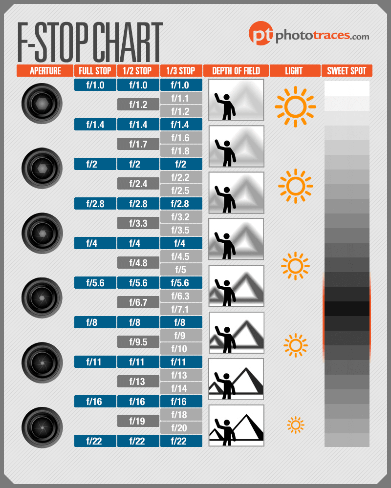

Phil, your progression will look like:-
Working down from aperture f/4 in half stops & every second aperture is the half stop!
f/4, f/3.4, f/2.8, f/2.4, f/2, f/1.7, f/1.4, f/1.2 & f/1
Use this graphic for more information....
