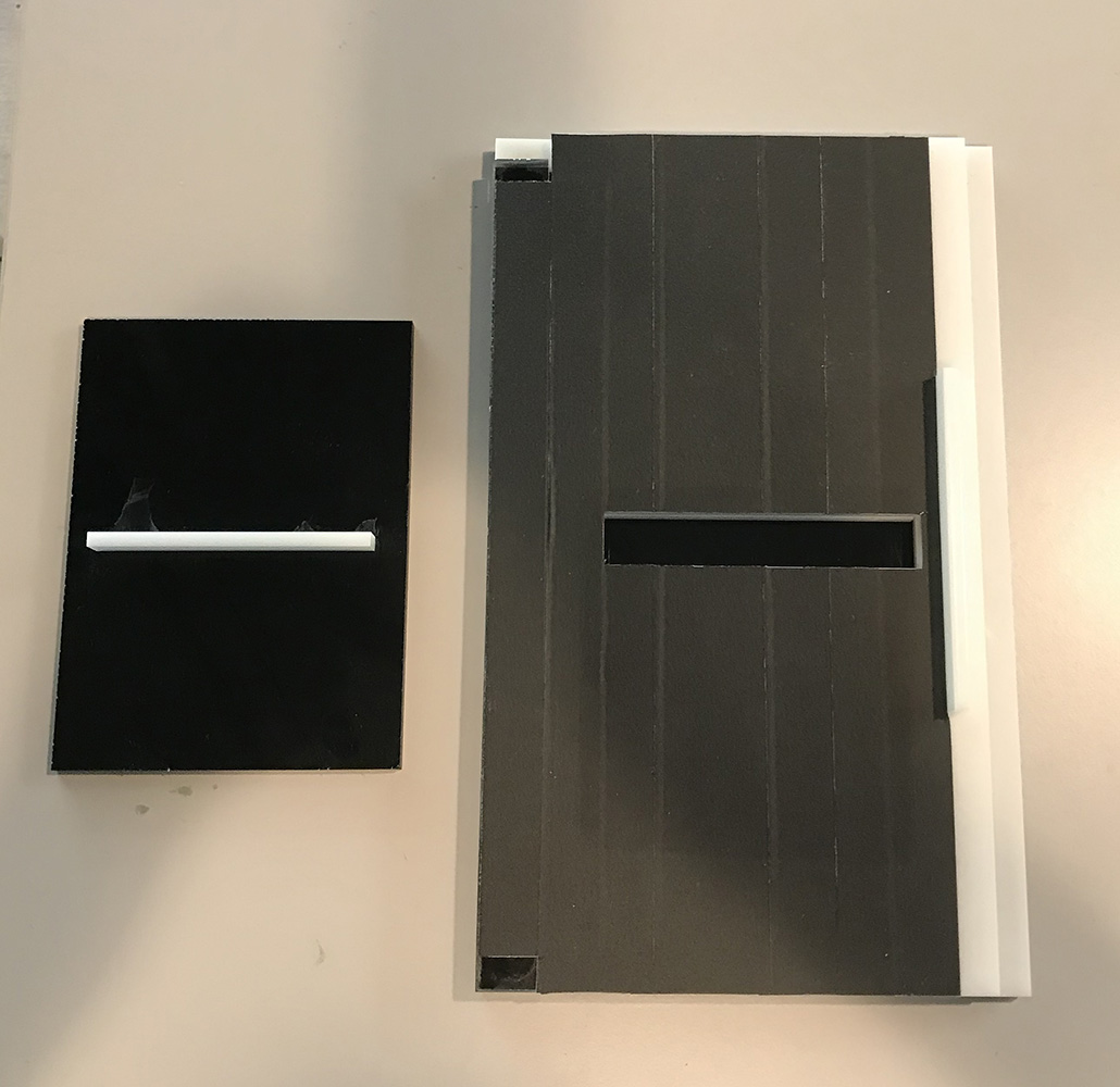

A very similar to a device is detailed in the book, Beyond Monochrome. There are drawings and dimensions to make your own. I made one out of laser-cut acrylic. It looks nice and I never use it.

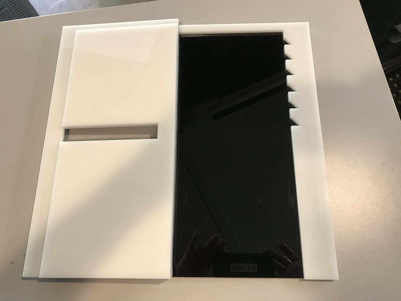

Here are some snaps of the test strip printer you can make from the instructions in Way Beyond Monochrome. The small panel is used with the printer open to produce conventional test strips. The top with the rectangular opening is used to make multiple exposures of the same area of an image by moving the paper between exposures. Using the notches inn the dark allows you to make these evenly spaced.

Nice! I saw the design in the Way Beyond Monochrome, very cool to see one made well. I made one from some cardboard, not very even without the notches but it kinda works. Especially handy to figure out how long to burn, or if the negative has too much change in density from one side to the next. One has to adjust your timer for every exposure so that makes it harder to use, I made my own timer to automate that.

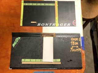

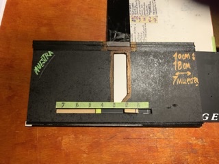

I share the
Finished model, 100% handmade.
The blade is taped on the left side and moves from right to left. Using the handle made of wood and moves to the mark of 2 and so to 7. The first one always eats ready to shoot. Attached are the images. I hope it's useful.

Having used the Ralph Lambrecht model now on many occasions the only modification which might on occasions be worthwhile is making the strip a little wider than one inch. Occasionally but only very occasionally, the one inch strip does not capture enough of the negative to get as many details as I'd like to make a decision but this is a very minor point

It is a point to improve ... previously had 2cm, change to 3 cm. the next step is to try ... I hope to give me time to perform these tests.
