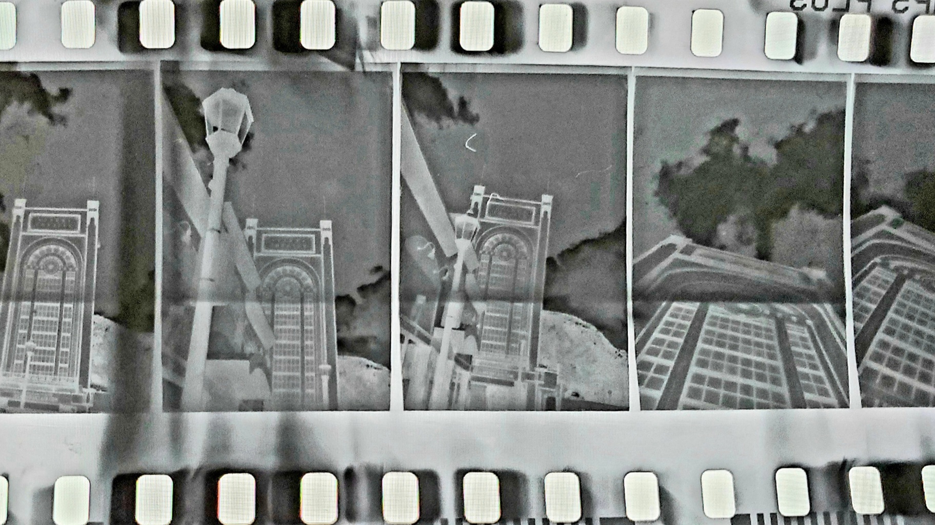

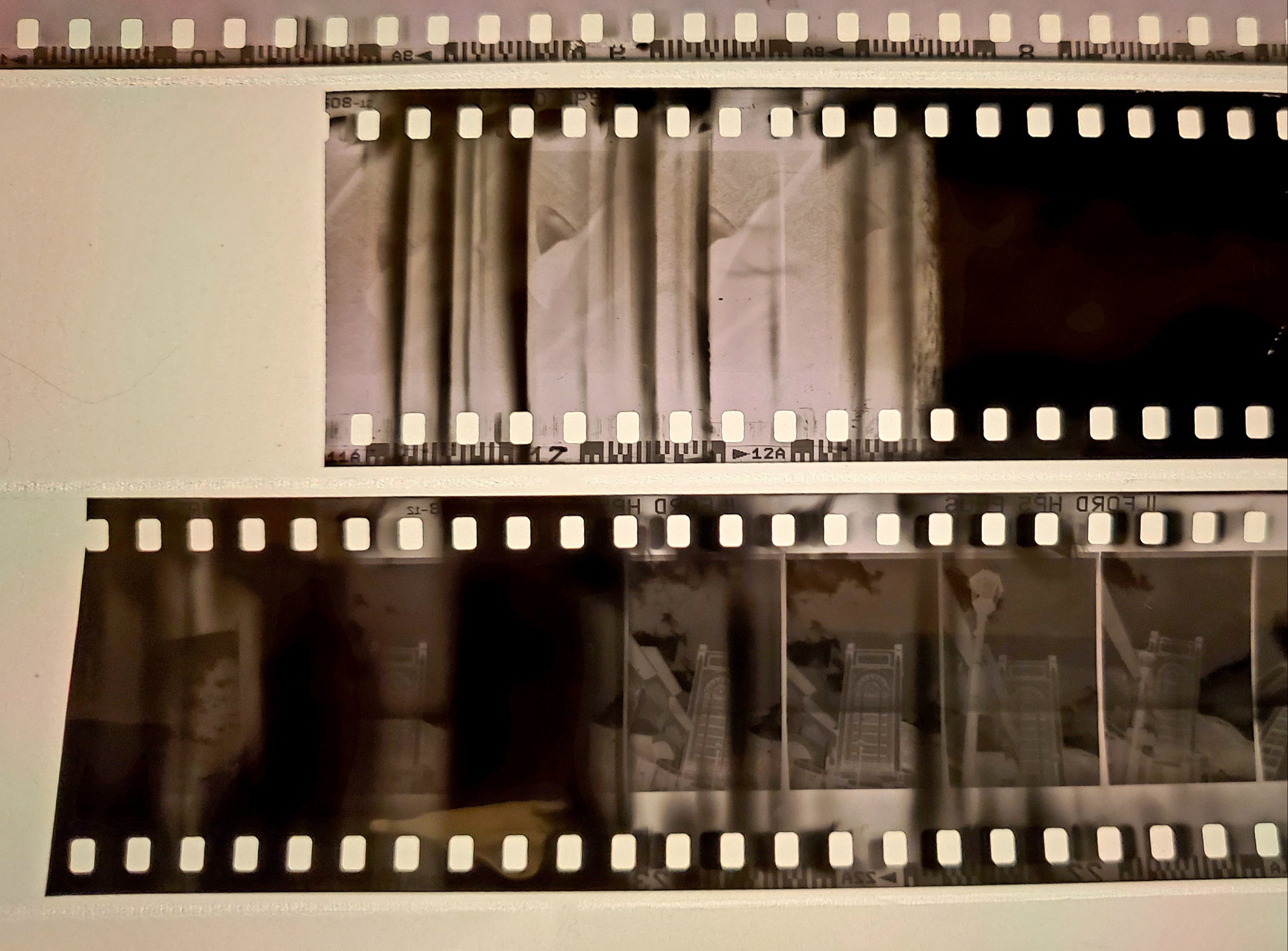

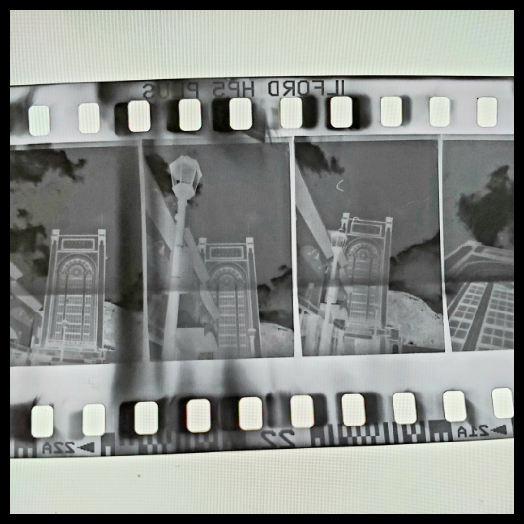

Since you have 5 Tessinas, I thought you might be able to answer another question for me. I've shot 2 strips of film with my Tessina and I'm getting these strange track marks in the last few exposures. The camera seems to be working fine and nothing is different when I shoot the last few images. I've attached a photo of the processed negatives. Anyway, I thought you might have an idea. Also, the film rewinds too, without any hitches. Thanks.

Lourie:
These defects don't look like they were made in camera. They look like light leakage or development artifacts. But I can't tell exactly what I'm looking at -- that is, which "marks" are properly part of the subject(s) and which are not.
It does strike me that the "stripes" are remarkable beyond the edges of the 14 x 21mm frame and, indeed, continue up between the perforations. That couldn't happen inside the camera.
But the "tracks" seem to run both latitudinally and longitudinally. That's impossible.
Tell me more about how the film was loaded and exposed, please. It appears you made (several) bursts of exposures. Is that right? How old is the ilford hp5 stock? Did you load the film into the Tessina cartridge using your daylight loader? Was there direct sunlight when you loaded the film? Can you show me a "proper" exposure that is immediately adjacent to one evidencing defects?
There must be a very simple explanation for all this.
Marc

Hi Marc, yes it's strange. I'm getting vertical black lines in the last few images and then, I'm getting horizontal white lines only in some images - not all. I'm shooting Ilford HP5 Plus 400 film, not expired. I'm processing with Cinestill df-96 (monobath stop fix developer) I'm using the daylight Tessina film loader. It seems to be working fine. And then, I'm rolling the film on to steel reels with a changing bag. Definitely picking up some light leaks somewhere, but don't understand the white, horizontal lines only through some images. Perhaps, it's the film cassette I'm using. Thanks for your help. I have such a fascination with Tessina cameras, and it's a lot of fun to be shooting with one again like I did 20 years ago. I'm just glad it's working and I'm getting images, despite these little problems. Thanks again, Lourie

This is a better image of the film strip.
Lourie,
Are you agitating the film for ~10 seconds every minute or so as soon as you've closed the lid of your tank and poured in the developer?
Marc

Yes, but I'm not inverting the tank because I have one 35mm roll in a 120 tank. (I also process 120mm film) I need to get another steel roll, or a 35 mm tank. First roll, I processed in a Patterson tank. I hate those plastic Patterson reels, so I just bought a 35mm steel reel. I didn't think about that, but it could also be an agitation problem.

Are you using a steel reel in a Paterson tank? If so, is the central core in place?
Most steel reels won't work in Paterson tanks, and if you are using a Paterson tank, the central core must be in place or it will leak light.

No, I'm not using the steel reel in the Patterson tank.
Yes, it's a mystery. I just ordered another 35mm steel reel and will make sure that the agitation is precise. The Tessina I've been using was just cleaned and all parts were lubed, so I should get a lot of images out of it (?) I hope so. It's such a delicate camera. Will post again when I process another roll with the proper agitation.
