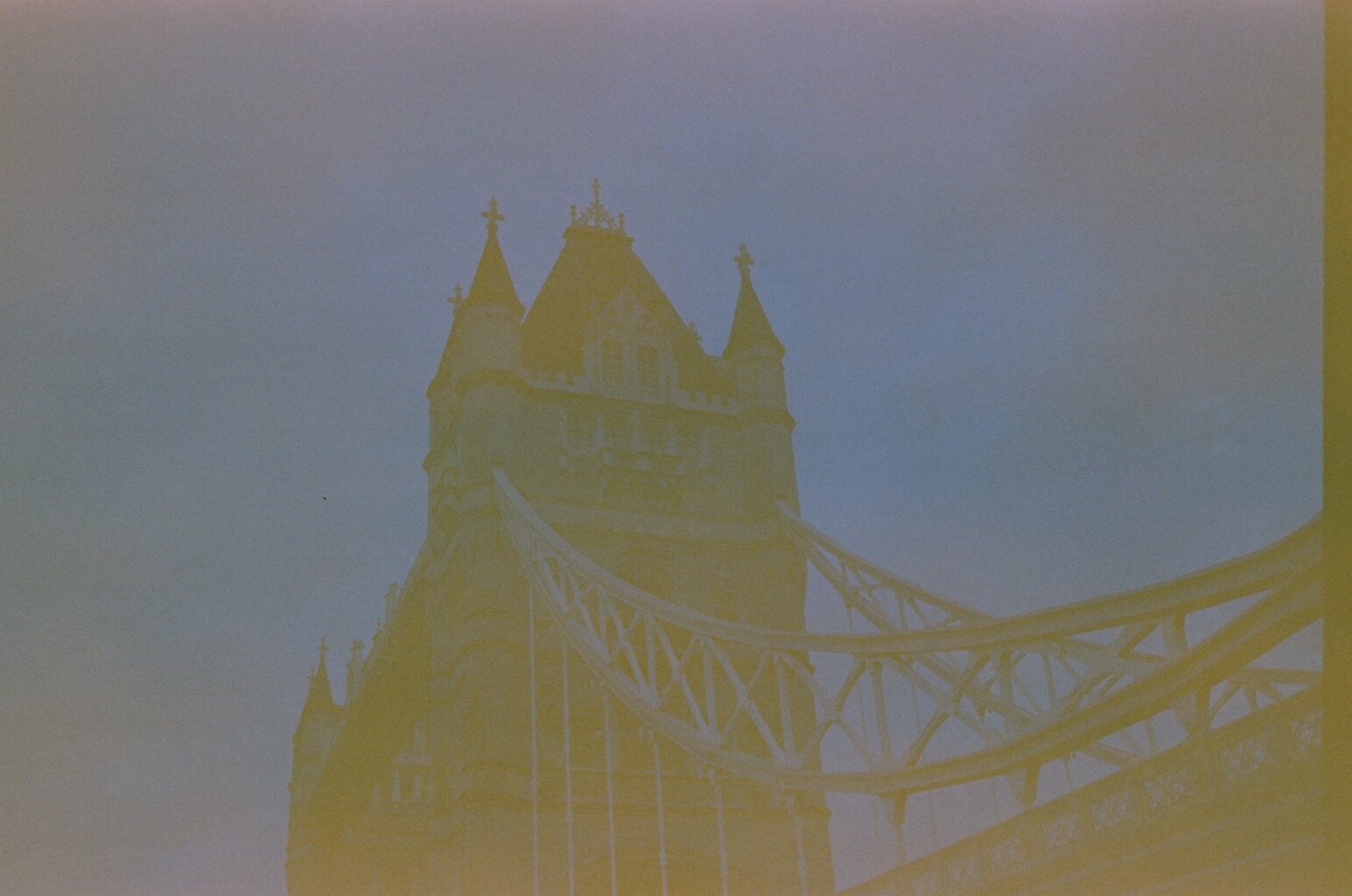

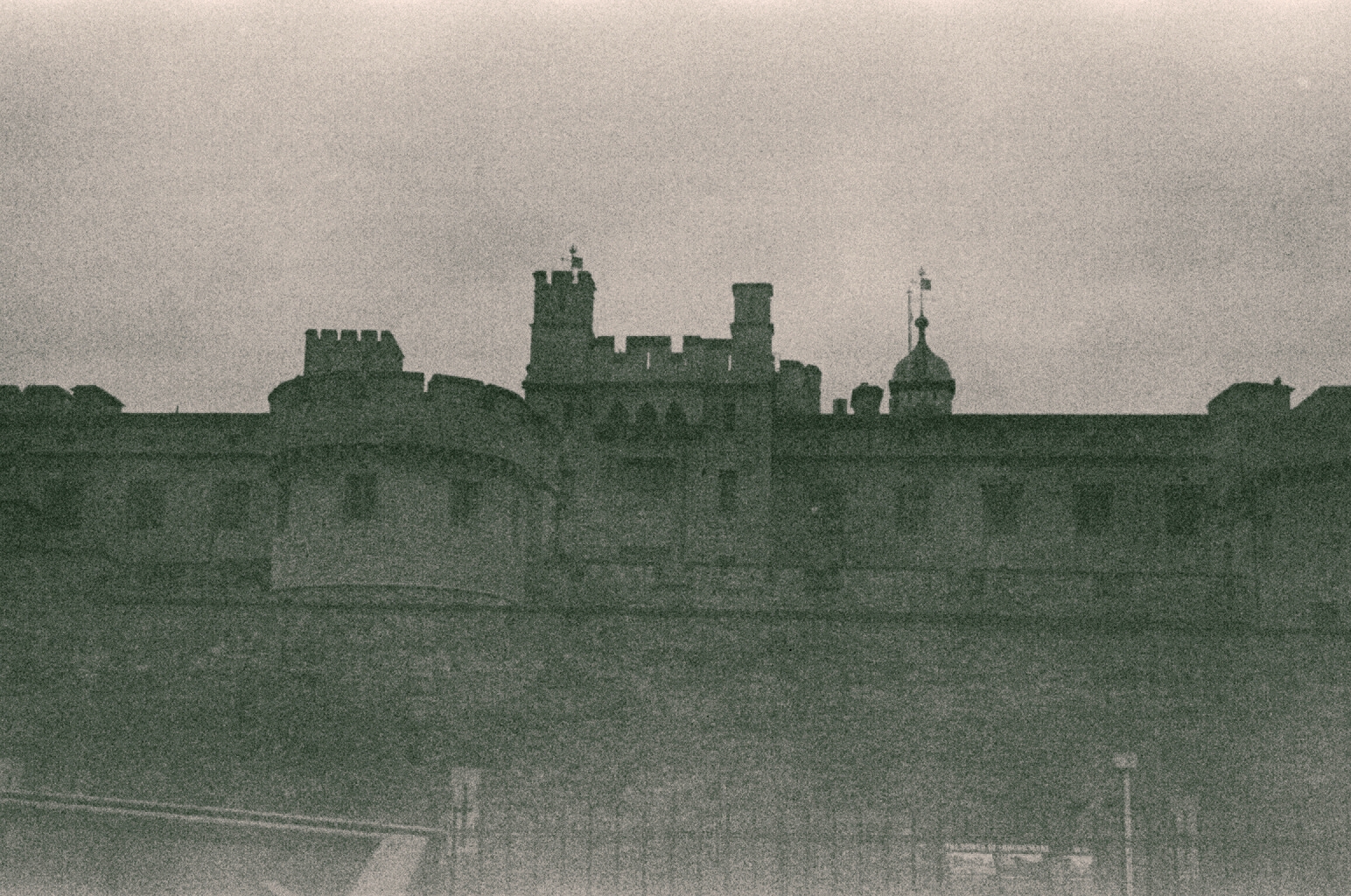

Hi Everyone,

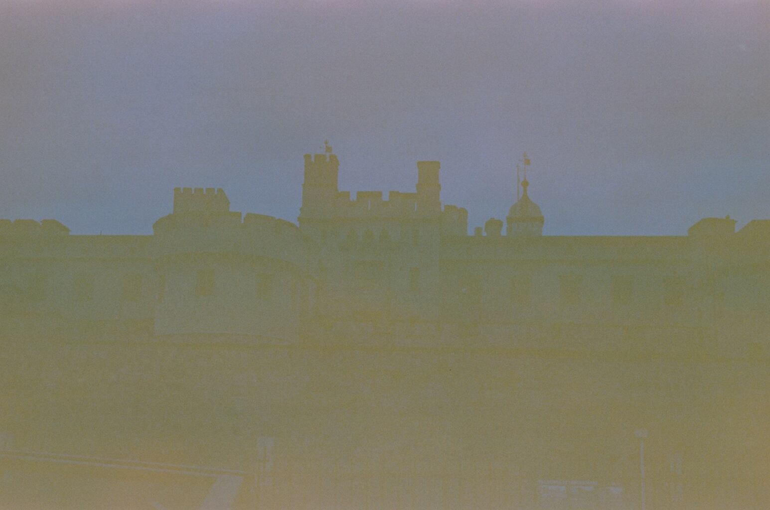

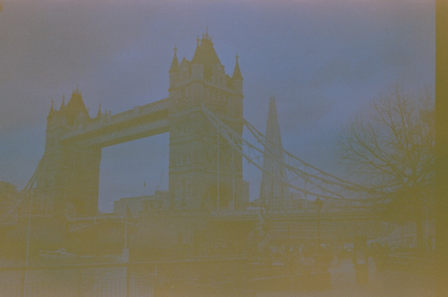

I recently bought a cheap old Canon T50 SLR point and shoot camera. It's a really old thing, but I enjoyed using it. Unfortunately, the camera doesn't have the settings and ability for me to adjust ISO, aperture or anything really. I took 32 photos with my first film roll - Kodak 400 ISO - and I set the switch on the back of the camera to 400 to match the ISO film (this is for the light sensor). The photos that were developed came out really terrible. They were all just dark without any detail or color. I've tried enhacing and improving them on photoshop, but the only way to make them even a little bit acceptance and visible is by adding a black and white filter and crancking up the contrast to the max. Have a look and let me know what, in your opinion, could be the issue here? I wonder if it was a dodgy film roll or if the camera is buggered.
The 3 images below is how they all turned out:

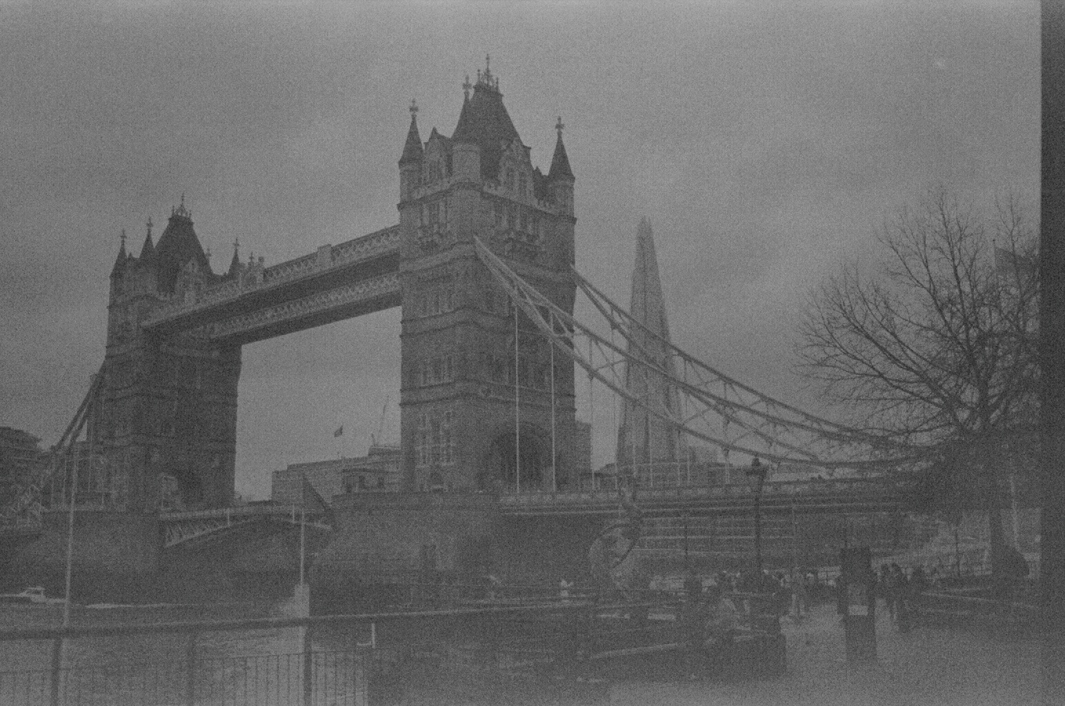

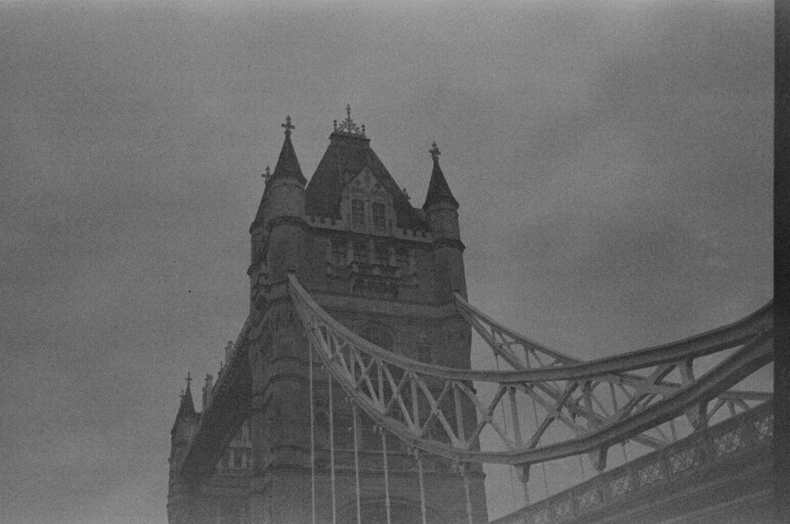

And the below is what you get by trying to improve them somehow:
You can set the aperture on the lens. With aperture ring on the lens set to 'A' the camera will work in Program-auto exposure mode. You can set the aperture on the lens to any value you like for aperture-priorty exposure. (not on the T50...) The film speed (ISO) dial is on the top of the camera, left side, combined with the rewind crank.
Kodak 400 ISO
Tri-X? TMAX? Portra? UltraMax? How old was the film?
Developed by whom, and how?
Please show a photo of the actual negatives so we can better see what's going on. Please see here for hints on how to do this: https://www.photrio.com/forum/resou...nsparencies-for-troubleshooting-purposes.461/
Overall, the problems you experience are most likely due to user error and/or digitization/scanning problems. The former is the most likely cause of this problem.

I had the aperture on the lens set at 1.8 the whole time.

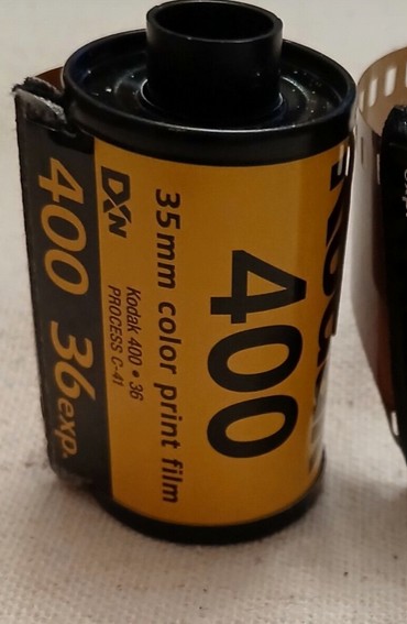

I'm not sure exactly which Kodak 400 it was. Here's a photo of the film canister. I don't know what the expiry date was.
I had them developed at a local photo developing shop where they do film development and printing etc.

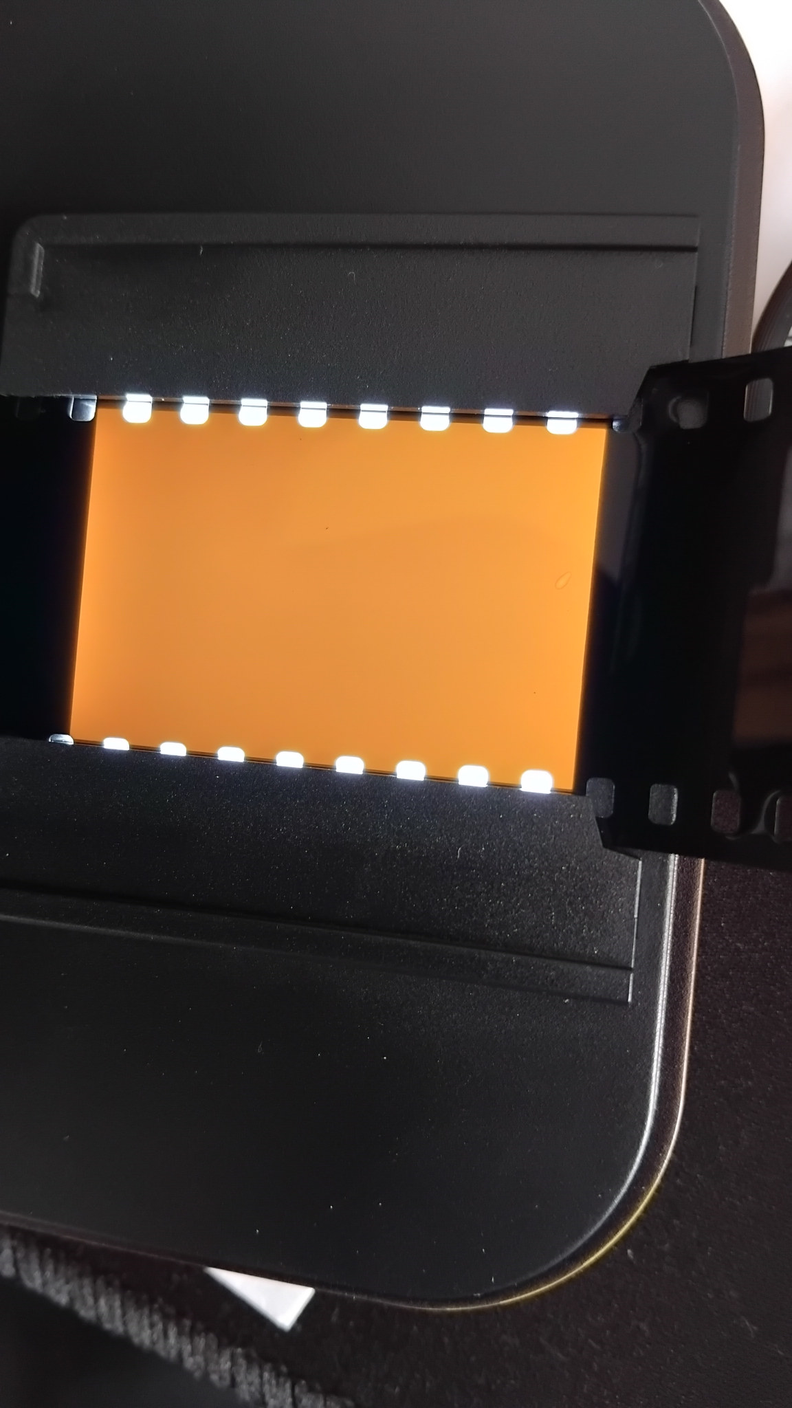

I've checked the negatives, and the whole film roll appears to be blank. It's just dark orange throughout and I don't see any images on it at all. I've also checked it all with a little 'Klim K2 Mobile Film Scanner', nothing shows up.
I'm not sure what to do. Should I go ask for my money back, or am I at fault here?
Why?
Did you note the shutter speeds the camera chose? Did they make sense? (sorry, you can't do that on a T50...)
What ISO is the camera set to?
This implies that the film was virtually unexposed. So either the camera chose a very high shutter speed that resulted in inadequate exposure, or the aperture wasn't set to f/1.8 as you thought it was. I think that's at least part of the problem given the depth of field in the street scene with the bridge in the background. The depth of field at f/1.8 would have been very small, yet everything in the scene is sharp. That must have been shot with a small aperture (large f/value).
I think you should read some basic texts about exposure and then try again with a fresh roll of film of known provenance. If you start with something like Kentmere in black & white, it'll be a somewhat cheaper experiment overall.

Looks like gross underexposure.
Here is the manual: https://www.cameramanuals.org/canon_pdf/canon_t50.pdf
The T50 is program AE only. It will shoot at 1/60 unless the lens is set at "A". Please check how the aperture behaves when not it "A"; maybe it stops down regardless hence the underexposure.
It's not a point and shoot. It requires manual focusing and setting up the ISO speed (around the rewind knob).
You're right!
I think @RonKolos is best served by getting another camera that gives more control over exposure, combined with studying a basic text/tutorial on metering & exposure. The camera doesn't have to be particularly fancy. Anything that works, allows manual aperture and/or shutter speed control and has a working light meter would be OK to start out with.

Ok, thanks both.
I'll give it a try with the aperture set to A on the lens next time. I probably accidentally moved the setting to something else why focusing the lens, but the A setting stays locked in place which is good.
