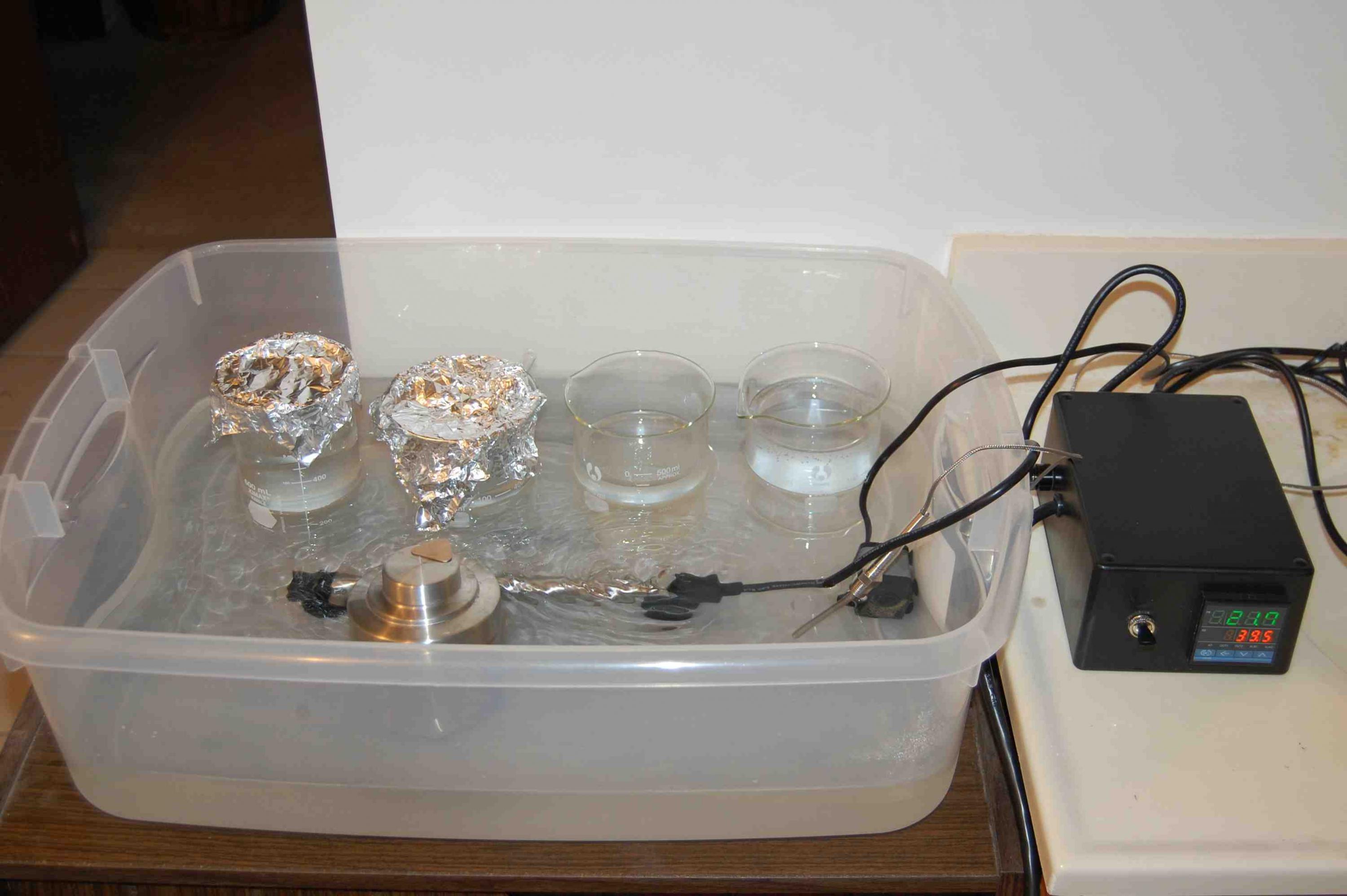

Here are some notes on the construction of the stabilized bath.
1. If you use the CD101 controller, the following files should be downloaded:
http://seattlefoodgeek.com/wp-conte...Instruction-Manul-including-PV-adjustment.pdf and
http://www.sure-electronics.net/measure,tools/TE-MT007_Ver1.0_EN.pdf
The first gives the additional settings and the second is a general CD101 manual.
2. If you use a Pt100 sensor, follow the directions in the first file to tell the controller about it. The Pt100 leads are usually color coded and should go to the following pins of the CD101:
red: pin 10
blue: pin 11
yellow: pin 12
3. The wiring is straightforward. The hot side of the power cord should go to a fuse (~3 A) immediately when it enters the box. The hot side of the cord is black, the neutral is white and the ground is green. After the fuse, the hot side should go to a switch and then to pin 4 of the CD101 (with an internal relay). Pin 5 goes to one side of the heater (or an outlet in the box). The neutral side of the power goes to the other heater connection (or outlet). Pins 1 and 2 should also go to the AC power, after the switch.
4. Be sure you order the correct version of the CD101 - there are many versions with different options. I believe one wants the 110 V ac input option and the internal relay (if a 250 W heater is sufficient). If you need more power, get the controller with the relay driver and purchase a 7-9 volt DC relay with sufficient current capacity (the Radio Shack #275-005 for $4.49 should work: it can switch 12 A). If you use my wiring with the wrong version, you can destroy the controller.
Here are some photos of the bath and a close-up of the controller in its box (I used a Radio Shack plastic box, 3"x5"x7"). The bath photo shows the heater (a long tube in the center of the bath), the pump (on the right side of the bath) and the sensor (sitting in the right side of the bath). The numbers on the controller are the set temperature (bottom) and actual temperature of the bath (they are different since the bath is heating up).

The one I ended up buying on ebay is slightly different than the CD101 as far as I can tell, but looks like it will serve my purposes. If I understand the meager data on ebay it will need the relay to drive the heater, but that's not a big deal. I'll know more when it arrives.
I like your simple implementation. Thanks for the photos.
