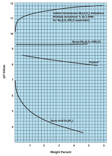

Sorry for resurrecting this one. Andrew - I'm having a crack at divided D-23. Do you have any idea how much borax is meant to go in per litre for bath b? I've found wildly varied results - Anchell and Troop indicated 18g for 500mL, but I've seen as low as 2g/L. I have 36g in a litre of water per Anchell and Troop, but that seemed excessive on reflection. My borax is granular, so that might explain some of the variation in weight if anhydrous is expected.
I'm not surprised; it's probably not critical in the least, for two reasons:
1: the pH of a borax solution is dead stable virtually regardless of how much you dissolve:
Source
2: In a 2-bath developer approach, the rate of development is governed mostly by the amount of developer the emulsion is capable of soaking up in the first bath. The second bath just needs to ensure that this developer can do its work.
As always, just try it out and adjust to taste.
