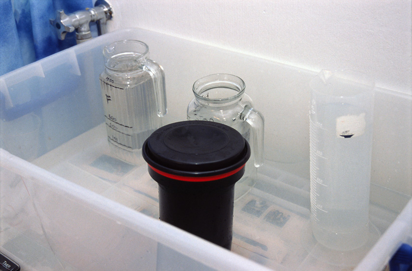

The water bath is way to go. I need to use it during summers to cool chems down to 24°C (75°F). During winters that's about the room temperature so it's easier.
Although I would like more to go lower temps like 20°C or 22°C to get longer developing times for negatives with low contrast but I have stuck in 24°C to keep things simple.
My setup is simple. Just make sure that there's enough water so that it's temperature does not change within one hour or two...
