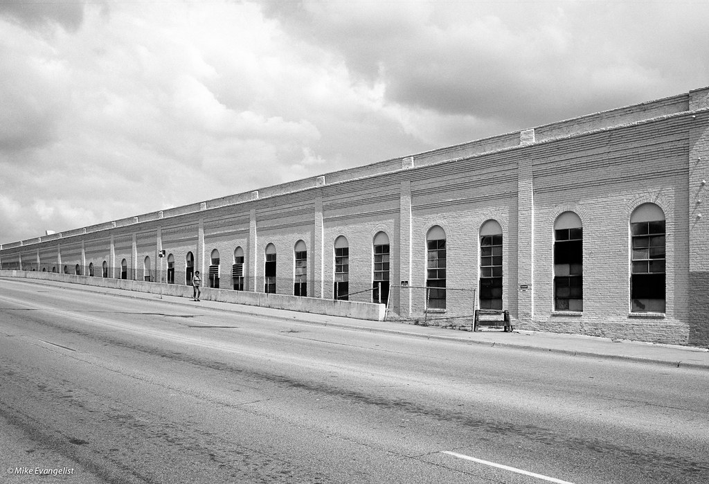

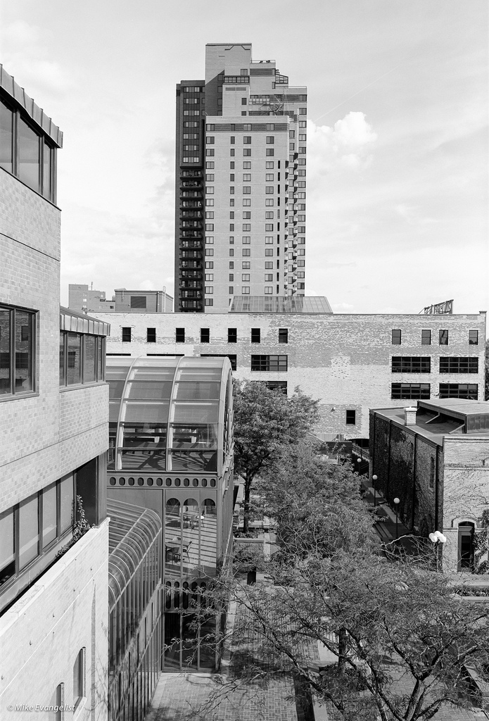

Echoing what others have said: excellent lens, relatively light, easy to focus. And lovely negatives. I love my GSW690 III.
Here's a couple recent shots on Tri-X.
Full rez versions here and here.

I own the GW690iii, GSW690iii, GF670 and GF670W - they are all excellent cameras. The main difference is not lens quality it basically comes down to larger image size, more rugged body, simpler mechanics, and lower price for the GW series versus lower weight, better handholding ergonomics, and built in meter for the GF series. Aspect ratio is a personal choice. I like 6x9 for its cropability but find 6x7 fine for most situations.
