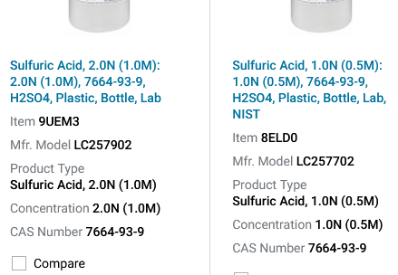

I am planning on embarking on this cleaner, specifically the TC-1.
In searching for acid I find listings for different concentrations, here is an example:
I have forgotten most of what I learned about chemistry in high school (1973) out side of safety procedures.
Thoughts?
Thoughts?
Thoughts?
Please find an alternative cleaner.
Your post says to me that you do not have even the minimum knowledge/experience to use this cleaner (which is called chromic acid in the chemical lab) safely. You need really good ventilation and very serious personal protective equipment.
The recipe cited above says clearly that you need concentrated sulfuric acid. Concentrated sulfuric acid is 18M and is very corrosive and nasty stuff to work with. I would be surprised is you can find a company that will sell this to an individual.
Furthermore, chromate salts are both toxic and carcinogenic. They are also very bad for the environment both in their manufacture and, in not treated correctly, in their disposal.
The mixture of these two compounds is downright nasty stuff. I am a retired chemistry professor and do not consider many chemicals 'nasty'.
When I started out in chemistry in the 70s, chromic acid was commonly used the the lab. We had big vats of it that we would soak glassware in to clean it. By the turn of the 21st century chromic acid for routine glassware cleaning was completely phased out. (It is still used in rare instances where there is not a good substitute.)
If professional chemists don't use the stuff, I think that it is prudent that photographers stay away from it as well.

My only stumbling block is the concentration of acid to purchase.
