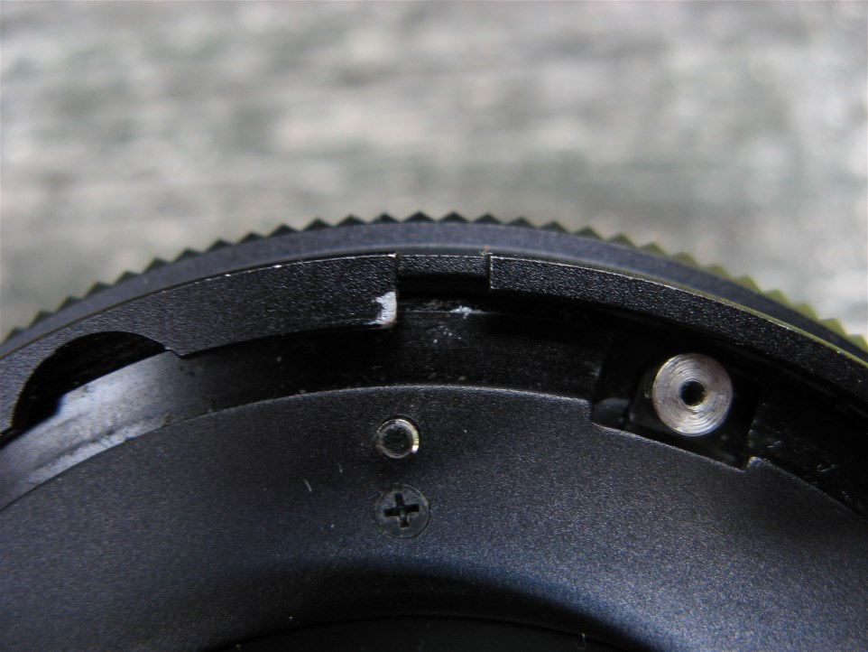

Problems do occur with shutters due to wear. I recently purchased two lenses from ebay (as-is cheapies) that had defective slow speeds. There is a way to tell from a photograph of the bayonet mount at the back of the lens how much use it has had from the wear marks. In the picture below notice in the center of the frame the black surface has been worn away exposing the bare metal and the original rectangular corner is rounded from mounting the lens on the camera. The more times a lens has been mounted the more this rounding occurs, and that is also a sign of how much use the shutter has had in the life of the lens. A lens may appear to have mint glass and casing but a worn bayonet mount shows the amount of use. A new lens has no bare metal and a sharp corner. This example has moderate wear, and a defective shutter.

The lens that gets the most use/wear is the 180mm (any), since it was used day in and day out in the studio. The cocking ring in the throat of the body has two holes that mate with shutter cocking pins on the back of the lens, if the body is hard used the holes may be elongated rather than round and in the worse case cannot turn the lens pins far enough to cock the lens's shutter. There are also leaf springs that support the film flatness rollers in the film back, another place to look for wear. Back in the day I always had a few sets on hand to swap into the backs and be advised that the later backs use a different spring than the earlier ones.
