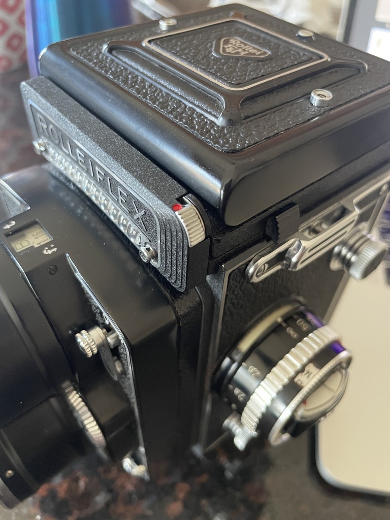

Hi folks,
Just picked up a tele-rolleiflex and was curious about two things:
1. What is the switch in the top corner of the name plate? Seems to affect the meter but can't seem to find anything in the manual.

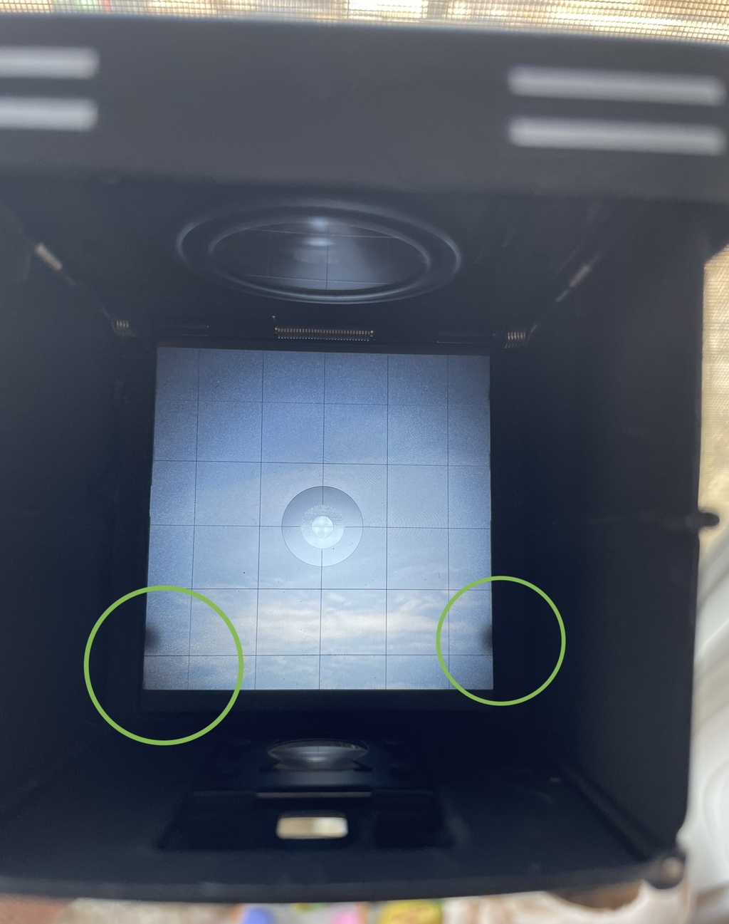

2. The ground glass is displaying these odd darkened marks- is this normal?

When the red dot is visible, use the numbers framed by red on the meter.

The two dark marks on the screen are the side tabs used to hold the mirror in place.
You can see these directly by-
1) Push in the two side button at the base of the focus hood and slide the hood back and off
2) The frame holding the focus screen will be exposed. Push the sides down a bit and slide the screen back a bit and then the frame will lift up, hinged on the back edge. You will now see the mirror and the side tabs.
Not sure what kind of screen you have, but I would not touch it until you know. If it is a Maxwell, it is very delicate. Blow it off is all for now.

Hey Dan, I don't know what kind of screen is installed. I have a spare maxwell i was going to put into it- do you know if theres a way to positively identify a maxwell screen?
I don't really have an answer. I just looked at the photo of the screen you showed and realized that I can't place what kind of screen that it is. But it is very even across the whole field. You might start a new thread showing it and see if someone can give an answer? I'd be curious myself.
The telephoto lens means that light is hitting the mirror more directly than with an 80mm lens. Meaning less loss as you get near the edges, inverse square and all that. Combined with a quality screen that keeps the edges bright, the retaining tabs will show more clearly as there is a larger difference between the dark tab and the surrounding reflective image.
