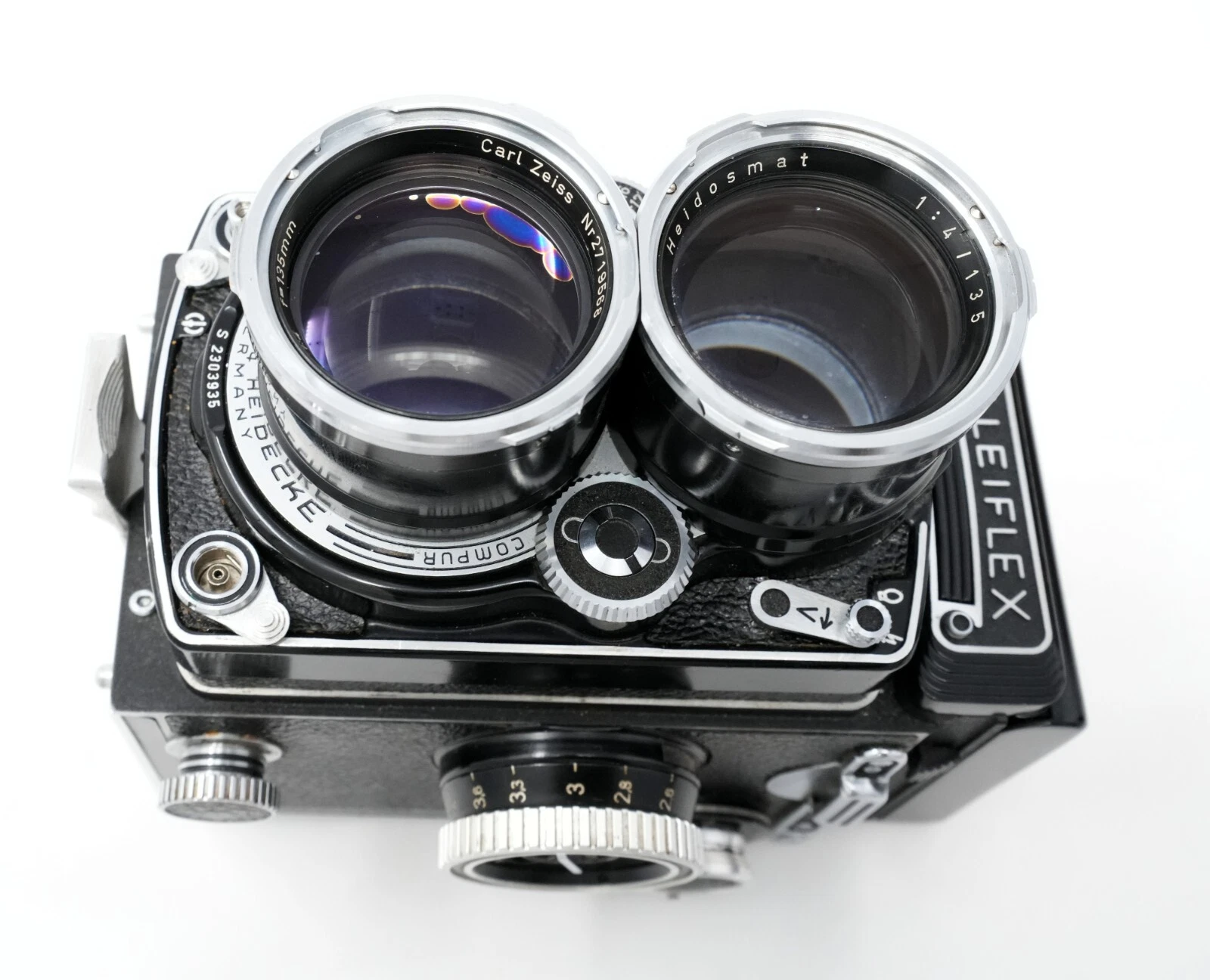

I knowingly bought a Tele-Rollei with lens separation for a good price. Can anyone tell me the best way to test it to see the effects if any the separation has. Will it only show up outdoors?

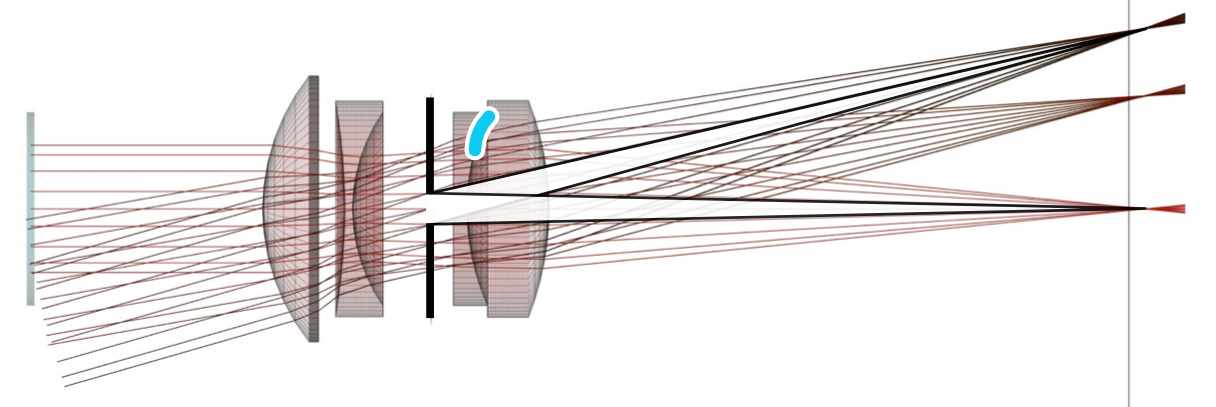

Depending on the aperture, maybe no effects. Test it wide open. Probably you got a good deal unless the separation is very bad.
The image below shows a Tessar (with only a single cemented unit). Yours may respond to stopping down the same way.

I received my Tele-Rollei today and it looks in good condition except for the lens separation and a couple of spots of fungus on the rear element. I would like to remove the fungus but I have never removed the lenses from this model before. Can anyone here give a quick instruction on removing the front taking lens group off so I can get to the inside of the rear element.
Here is the camera I bought, but I didn't pay that price.
