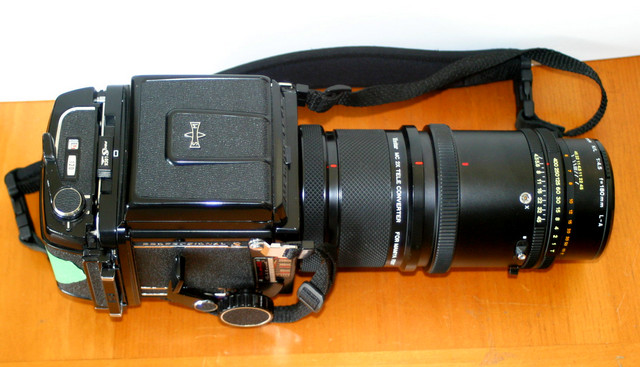

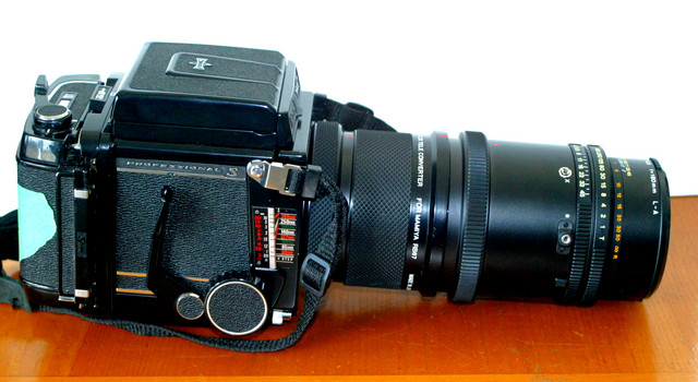

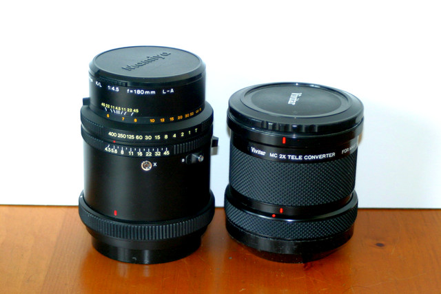

Scott:
In case you were thinking of something to hand-hold :smile::
(RB67 Pro S, teleconverter and 180mm K/L lens)
