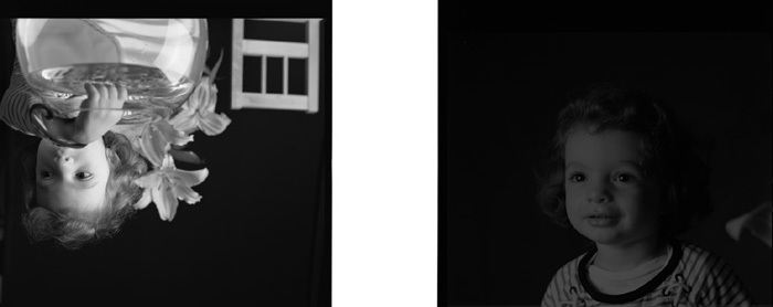

UPDATE:
Ok, I tried two rolls of 120 TP, shot side by side with studio lighting - so no metering differences / light differences possible there. Both rolls shot at 25 EI, but one developed in Technidol (9' with shaker agitation every minute - classic instructions) and the other in Rodinal 1:150 (specifically 4:600, 7' with initial 30 sec agitation, and two gentle inversions at 5, 3 and 1 minutes)
Two negatives scanned in the same pass to give equal exposure settings are here.
Why am I nowhere even close to full development with the Rodinal? :sad:

hmmmm I think you are just under-agitated with the Rodinal.
I am pretty sure I used a standard agitation schedule with the 1:150 Rodinal Dilution to get good development with the seven minute time. (standard for me= five tank inversions each minute)
Hope this helps,

Thx Ian. I guess I have become paranoid of blown highlight with over-agitated Rodinal, that coupled with paranoia surrounding TP means thin negs? Everyone seems ok with "2 gentle inversions every two minutes". I'll try one with the "standard" agitation regimen.
