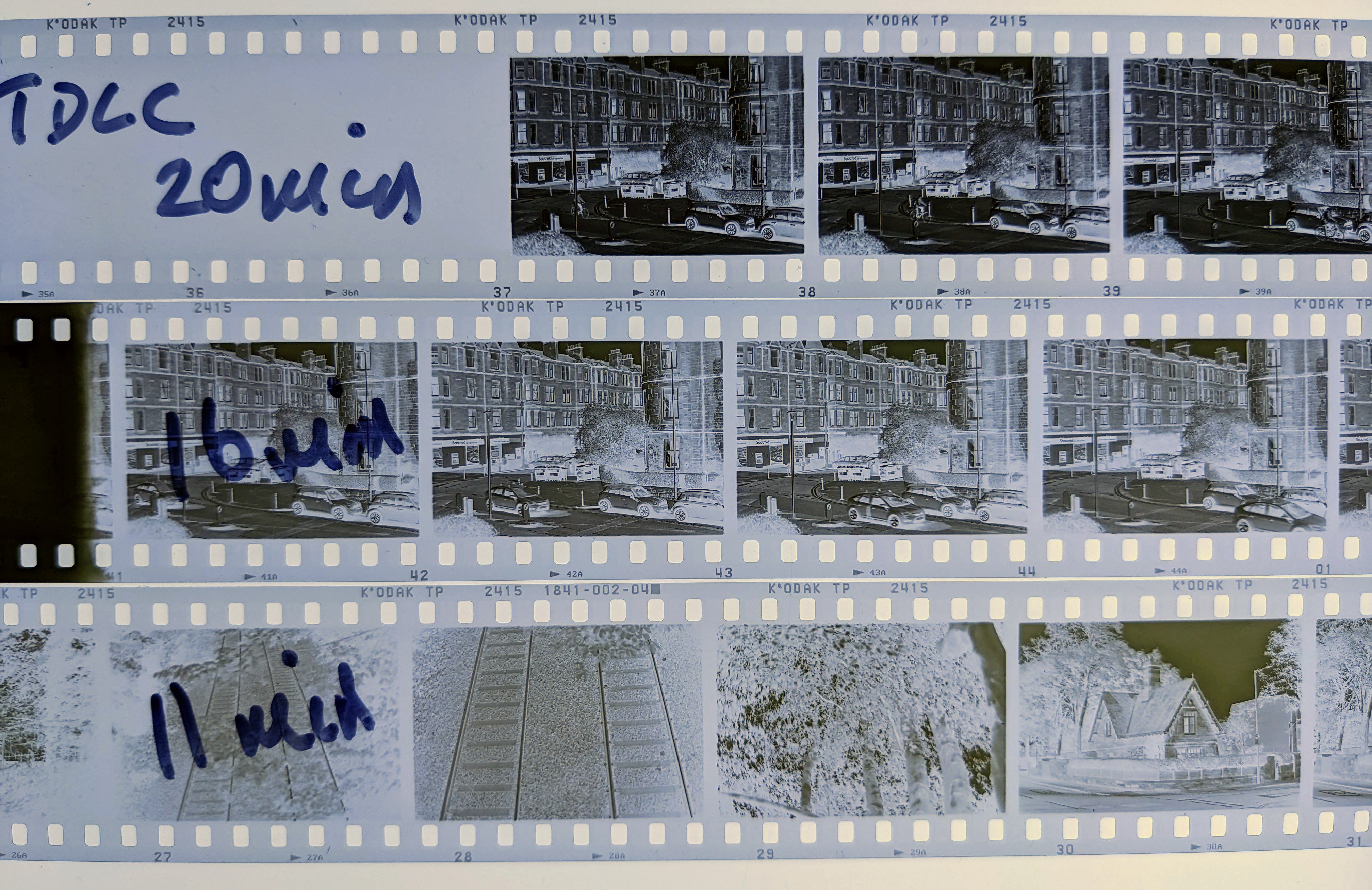

Here is a phone snap of the negs. Just clip testing film with different times. They were done in the order 11min, 20min (some dry plates), 16mins. Rated at ISO 12.
I'll have a go at printing on multigrade tomorrow probably, the 20min and 16min ones, the 11min ones look too thin.
I make my own silver gelatine dry plates which I've always dev'd in Ilford PQ or maybe Ilfotec HC (HC-110) and found very contrasty and only suitable for printing out processes or scanning. But I souped a couple in this stuff today and the look like they might print on MG, maybe too soft! I'll know tomorrow. They take the night to dry.
Yeah. I'd say that the 16 min ones will print OK although I personally like to see a tad more shadow detail. YMMV. The 20 min ones look pretty bullet proof; they'll print, but generally the highlights don't stand up too well against this kind of density. Things tend to get fuzzy and ill-difined in those murky depths of silver deposits.
My suspicion is this dev is a make-it-each-time-you-use-it one but that it will be good for a bunch of films.
I'd certainly approach it that way in your place. It's still dirt cheap and relatively mild on the green stuff outdoors, though. I wouldn't sweat it.

The 16 minute ones look like they'll print easily at grade 2. If you want lower contrast with copy films, you need to photograph lower contrast scenes.
