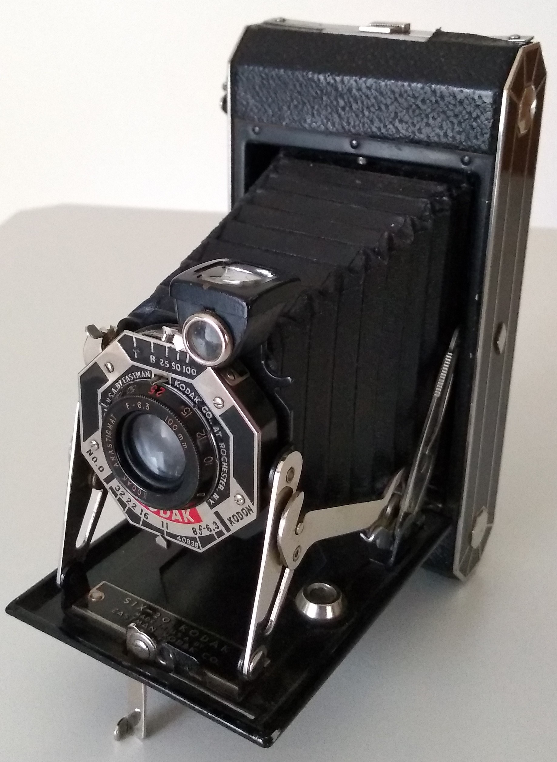

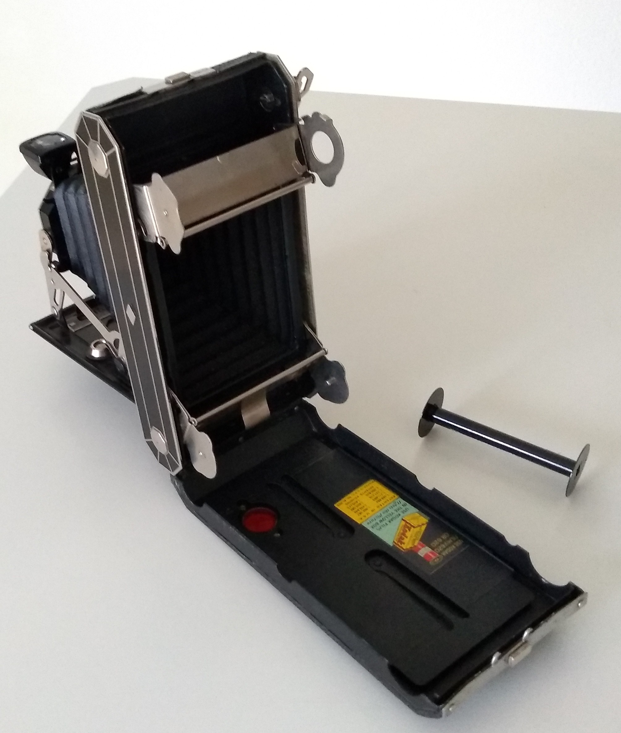

This is my project, the bellows are riddled with pinholes in all the creases:
Otherwise, the camera is perfect. Look how the spool holders swing out!
