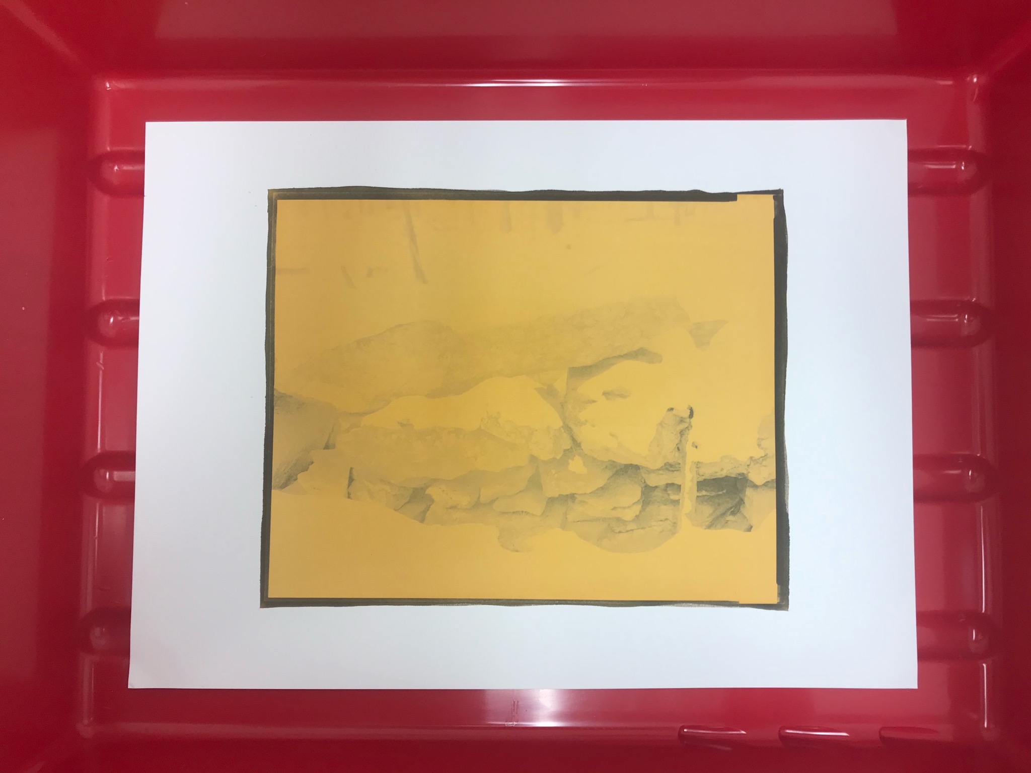

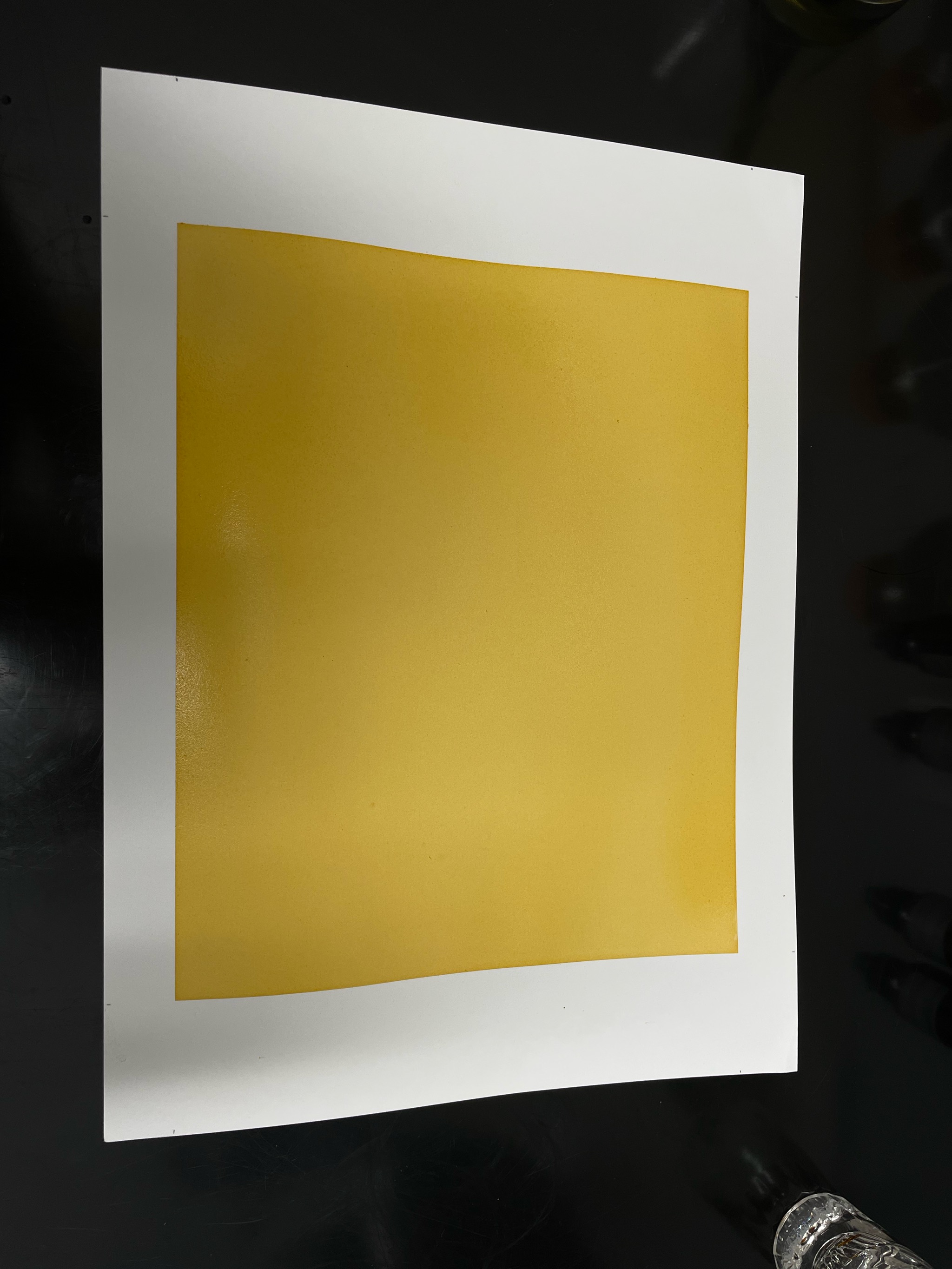

osella
Apr 1, 2013
115
Vermont
8x10 Format
