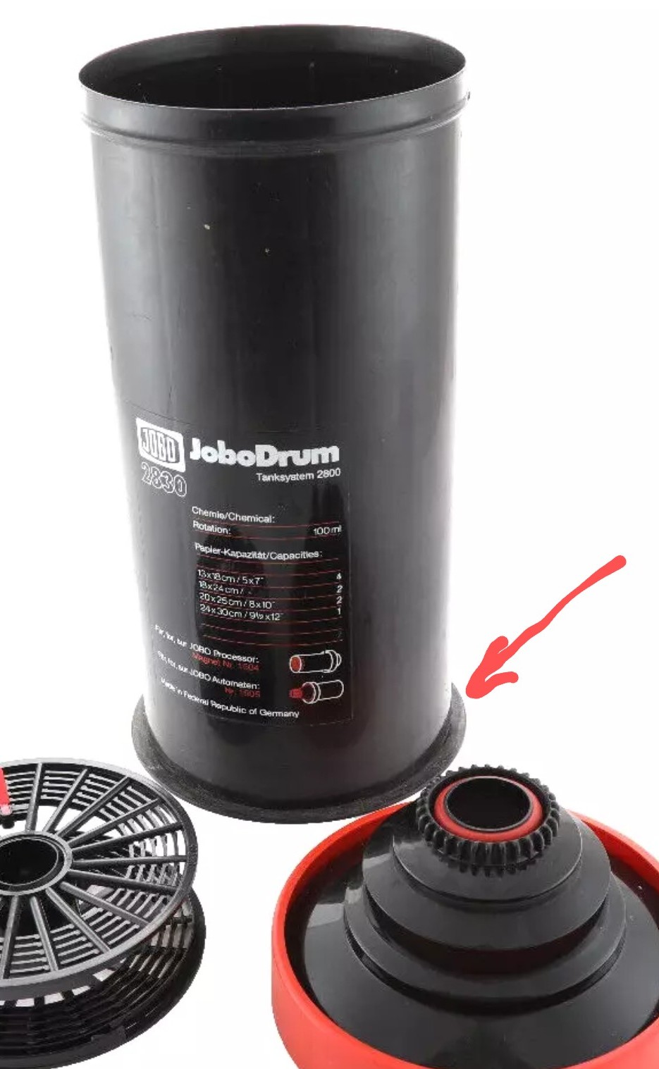

The lid you've shown is for the smaller diameter 1500 series tank. I would suggest you get in touch with Catlabs. They may have a used 2830 tank and magnet. The tank needs the correct lid and a cup inside not the funnel.
Here's a picture from Catlabs. Last I checked Jobo doesn't make print tanks.
Again you need ordinary cap with the inside cup.

Jobo 2000 series tanks had a base allowing to roll them manually on a flat surface like a table, so no processor or set of rolls are needed.
