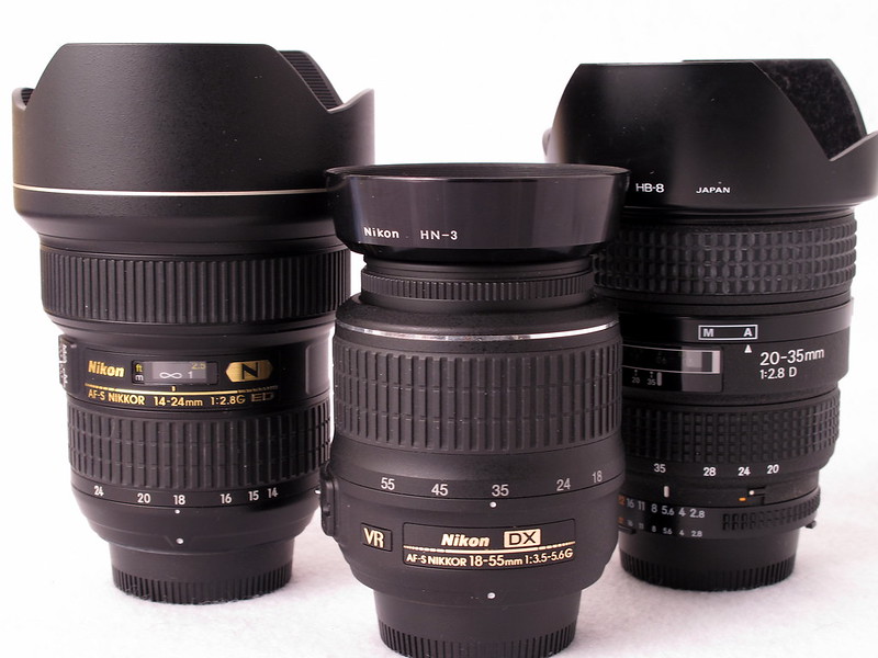

The Nikkor 20-35 f/2.8 auto focus lens (right) is one of my favorite wide-angle zooms. It is very useful when I do not wish to carry my 18/24/28/35mm prime lenses.
Nikon Zooms by Narsuitus, on Flickr
