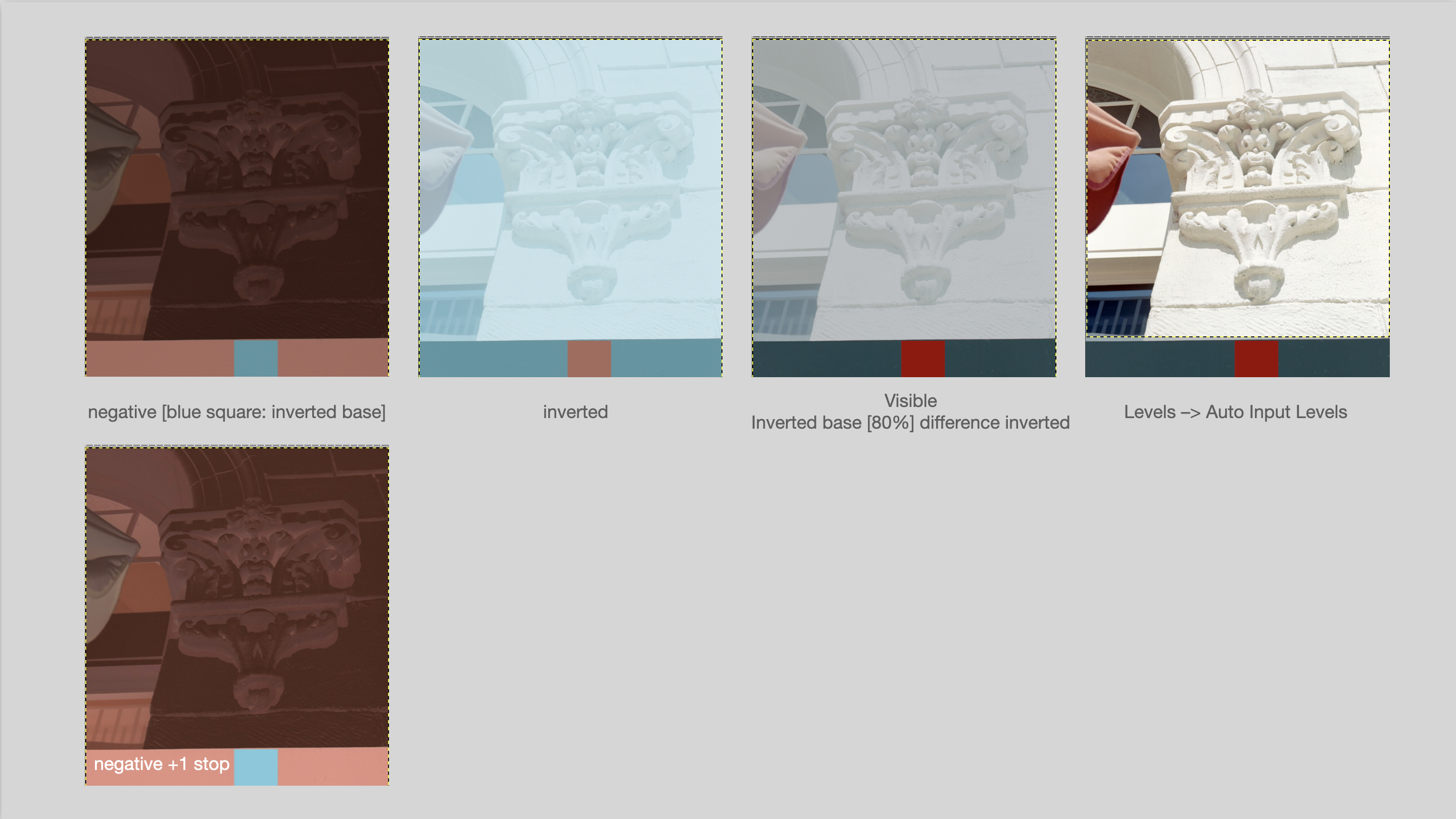

Some people complain that the scanning software is opaque, makes too many automatic adjustments and is far too difficult to use [Vuescan is particularly problematic]. And software is expensive. The scanning software I've used [Vuescan, SilverFast] suffer from feature bloat [too many features with little payoff, also see PhotoShop :pinch:]. Although Epson offers free downloads of SilverFast which I tested, I chose Epson Scan 2. On Mac OSX, Image Capture is also a good choice.
Consider using scanning software as little as possible and doing the post-processing in Photoshop/Gimp/… You'll manipulate the image with that software anyway.
Scan negatives as positives without making any changes [a pure scan]. Epson Scan 2 supports this approach.
  • Include a portion of the film base to remove the colour cast later.
  • When scanned, colour negatives will look orange [film base] while black-white negatives will be grey [film base]. After inverting the image, subtract the inverted film base.
  • Manipulate the brown-tinted image.
Hints
  • Before inverting I've manipulated negatives in Gimp using Levels -> Auto Input Levels [or carefully setting the R, G, B curves as well as the composite curve].
  • You can save the curves as presets to process other images [In Gimp, save the relevant presets are in Colors -≥ Levels… and Colors -> Curves]. You'll need presets for each film as well as for pushing [-1, -2] and pulling [+1, +2].
Complete details
  • Alex Burke Manual Inversion of Color Negative film
https://www.alexburkephoto.com/blog/2019/10/16/manual-inversion-of-color-negative-film
  • Although Burke uses Gimp, it is easy to modify his process to use Photoshop
Alex Burke also describes how to manipulate colour negatives to extract maximum detail, using the [old version of the Epson scanning software for some processing and then Gimp for the rest.
