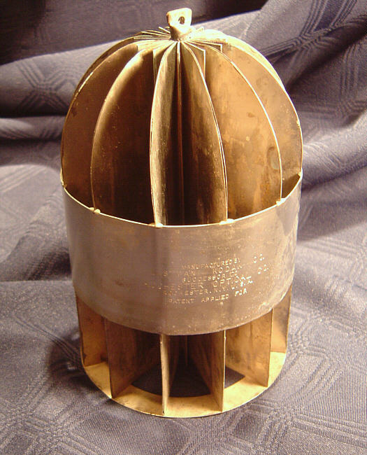

Or, use a Kodak taco tank. Here is the insert:
