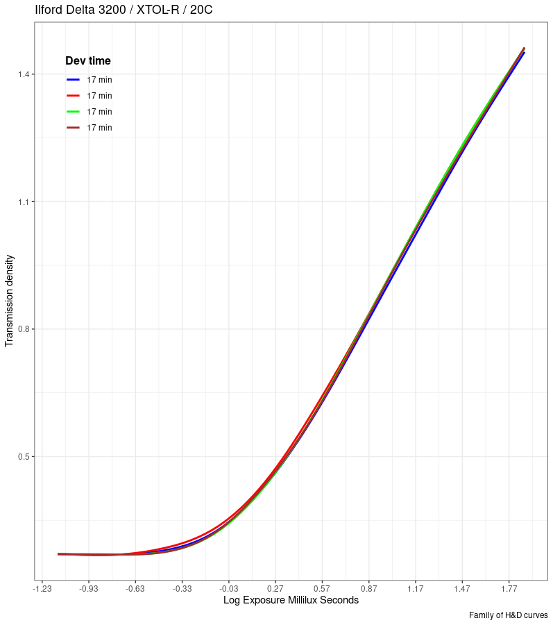

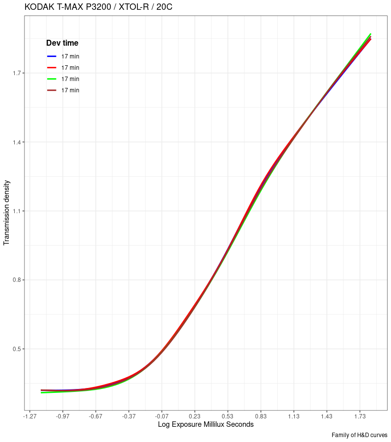

Yes, I thought of this, too. It's a very good observation regarding replenishing XTOL. In fact, prior to running these tests, I did a pretty thorough test of replenished XTOL, and it fully stabilized after about the equivalent of twenty 36-exposure films. It was pretty stable after about ten, but it became solid after about twenty. Here are the plots of four consecutive developments showing very good consistency. I have since settled on 90 ml of replenishment per roll of film (or equivalent). I described it in more detail in this thread. I have so far learned to live with the workflow of XTOL-R because it can produce very nice results with some of my favorite films. It's not a magic developer, but it can be dependable, at least in my experience.
