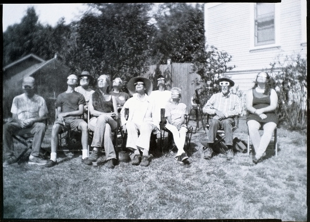

If the calotype is made wet ( the still-wet calotype paper is used in the camera ) exposures in bright sun with a fast lens can be well under a minute, maybe as little as 10 or 15 seconds. And they had all kinds of tricks and contraptions like neck braces that could be out of sight of the camera and help people remain still.
Even with dry calotypes it's possible:
This one was a 3 minute exposure on a dry calotype ( That's me on the left looking at my watch timing the exposure, and I'm the most blurry because I ran in and out of the picture to operate the camera :smile: )

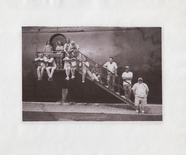

This was a 2 minute exposure on a dry calotype:
Calo III
par Ned, on ipernity
Not perfect, but not too bad when everyone tries not to move. Usually you can see some blur in old calotypes of people.
