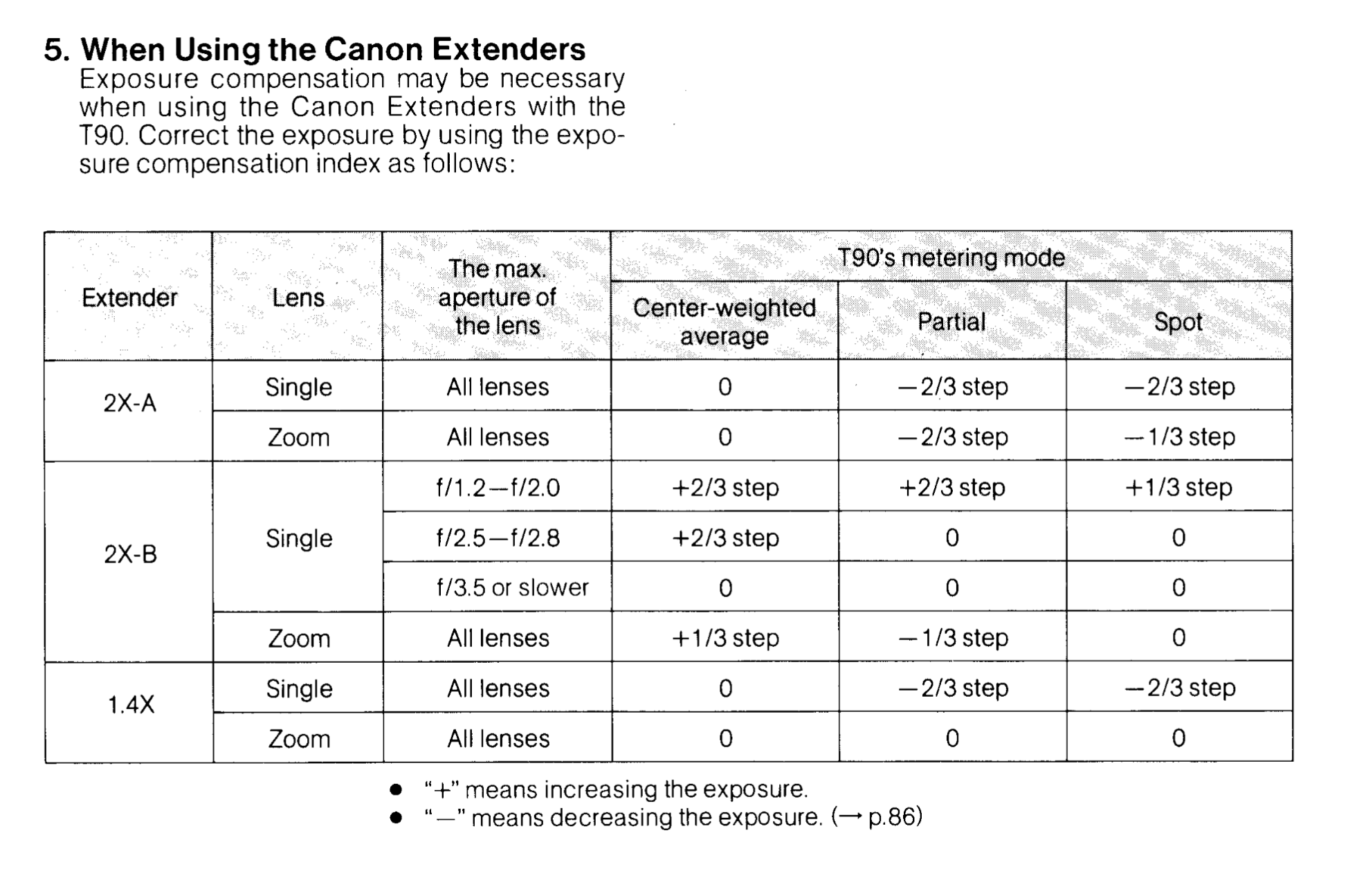

I plan to go out with the T90 and teleconverter this weekend, so I was flipping through the manual. Good thing I did, I had no idea they required adjustments to exposure beyond the normal 1 or 2 stops of light loss.
Does anyone know the reason for it?

I haven't gotten a response on this but I think it must be because the optical path to the light meter has some important differences with the optical path to the film. This could also have implications that light meter readings are inaccurate with certain lenses even without the teleconverter, as I've experienced with my FL 58mm f/1.2 lens.

Thank you! That image is extremely helpful. I'll add it here in case it comes up in anyone else's search.

I ended up printing out that page of the manual on a laminated card to put in my camera bag for reference. Though, planning to just stick to spot metering which will mean setting it on -2/3 the whole time.
When I get my 58mm f/1.2 lens back from servicing, I'll have to experiment and come up with an exposure compensation chart for that as well.

I think the brief answer to this is that each teleconverter changes the location of the exit pupil, and that affects the angles at which the light beams are incident on the different metering systems, and probably the amount of vignetting within the optics in front of the meter cell (for the spot meter at least). The teleconverters also may vignette fast lenses, so that the effect on fast lenses is different from slow lenses.
Makes sense but I think this would also apply to different lenses generally without teleconverters, no? I'll have to test it when I get time.
