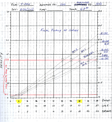

Have you tried using D-76 1:1 with your sheet film to see if there is a difference you can detect? I use the 1:1 dilution with my 4x5 TMX with good results. I have attached the speed test curve and the development time curves for your reference. I use a daylight tank with inversion agitaiton.
