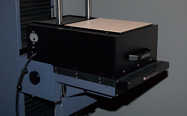

I also mounted an Aristo T-12 to my Durst L1840. I use this system for the majority of my work, and since the Aristo runs so much cooler and quieter, I much prefer it to the Durst DIchro head.
At first I placed the Aristo on top of the neg carrier, but I found the Aristo leaked light through it’s case vents. So I installed an empty Durst condenser head and placed the Aristo in the open bottom section. I then fabricated a “door” to the open condenser bay, and now I’m light tight.
Enjoy your Aristo, I love mine.
I don’t mean to hijack largeformat pat’s thread, but here are some pics of my conversion…..
I removed the top section from a Durst condenser head and placed the Aristo in a 12x12 filter drawer and slid the assembly into the open condenser bottom section. To make this assembly light tight, I fabricated a larger aluminum door or front for the filter drawer, and cut pieces of plywood and matt board to fit the open top of the condenser case. These plywood pieces are easily removable, and during long printing sessions I’ll remove them and check for heat buildup. So far I haven't had a problem. The cords thread through a small hole in the condenser shell and out the back through a vent hole.

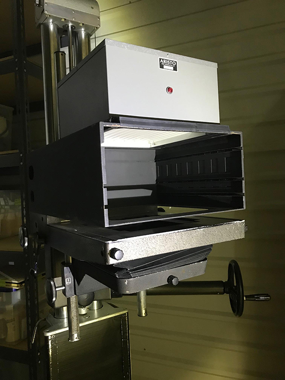

I like your style. With this thread being 9 years old, I was wondering if you had any problems arise with this particular solution? I am looking to purchase a used L184 and modify it just as you described. The unit is missing a negative carrier and lens boards. The less money I can pump into this endeavor the better. I have been printing 8x10 contacts for some time and would love a 810 enlarger. Any words of wisdom would be appreciated.
