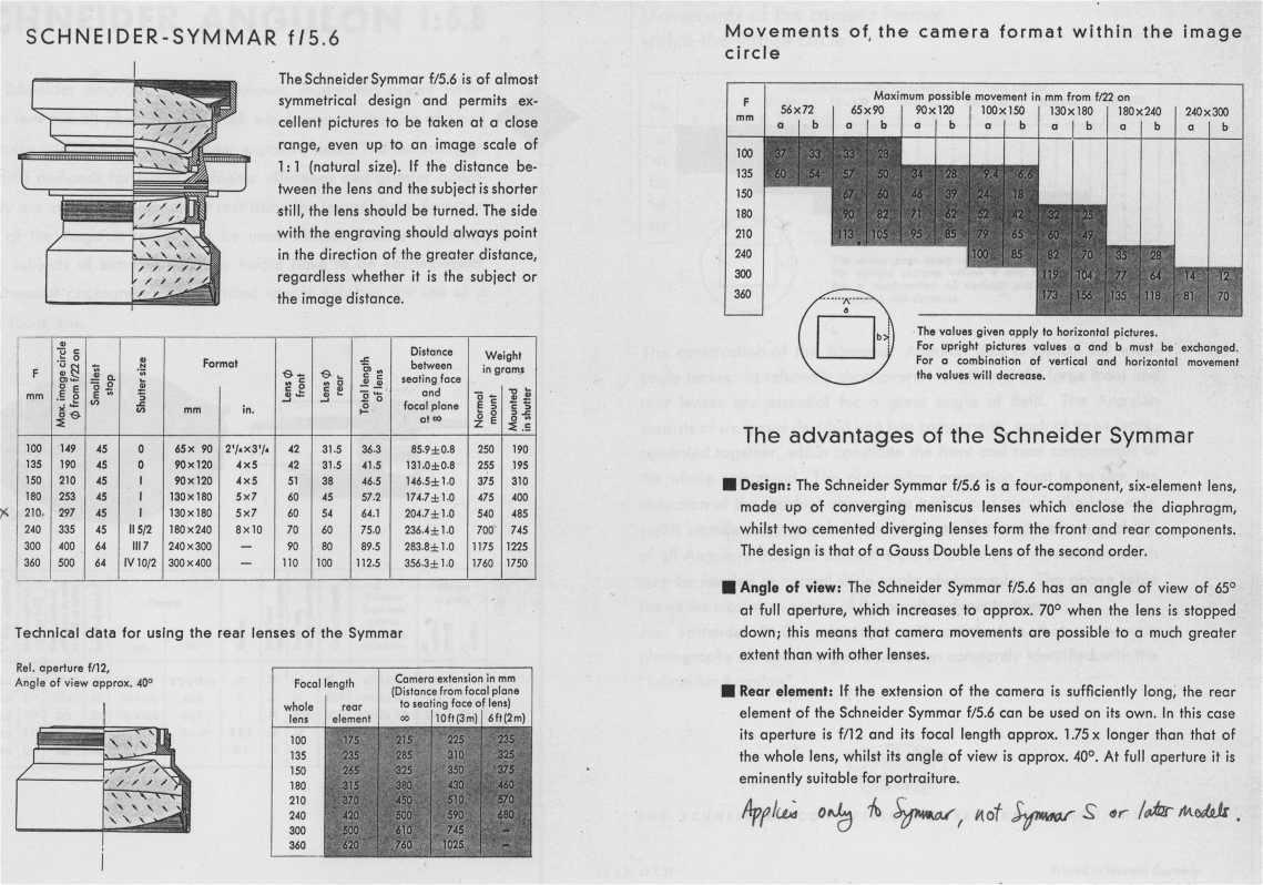

Here is the technical information for the Symmar convertible series published by Schneider. The 240mm is an 8 x 10 lens and some remarks about the performance accompany the tables.
