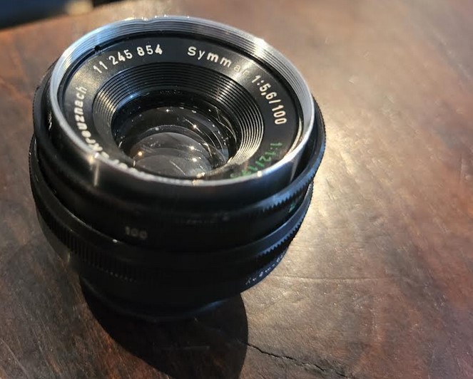

Hi all,
I recently got hold of a durst m800 to get back printing up to 6x6 negatives and it's almost in working order now.
The enlarger came with a Symmar 100mm lens, which I assume can be used for 6X7-6X9 negatives, which I'd like to give a try to at some point.
I've never seen this lens mentioned for enlarging before. It seems a nice piece of glass. Anyone heard of it for this purpose? It screws on one of the holder plates.

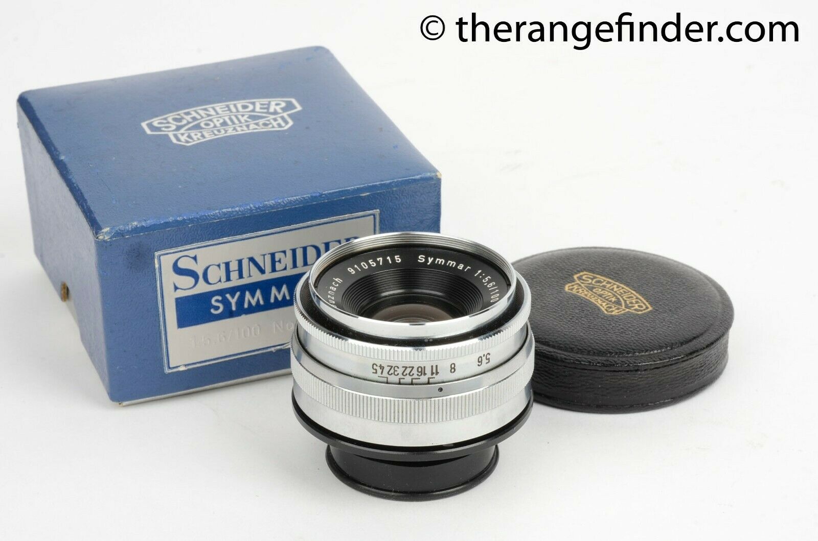

Like this? Looks like it is packaged as an enlarging lens to me.

It does look like that one, a bit more used (but better than it appears in the pic).
only solution is trying it out I think
