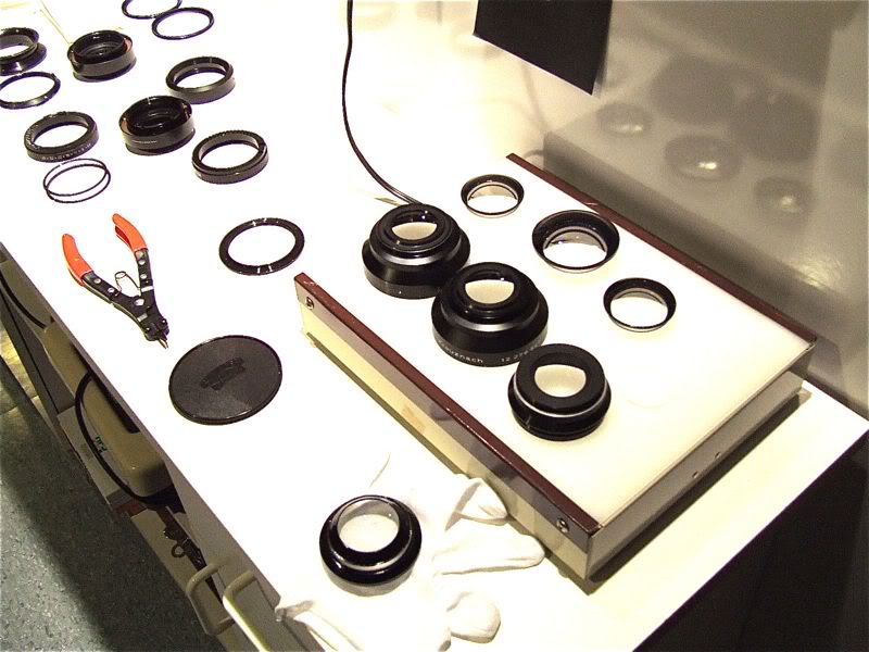

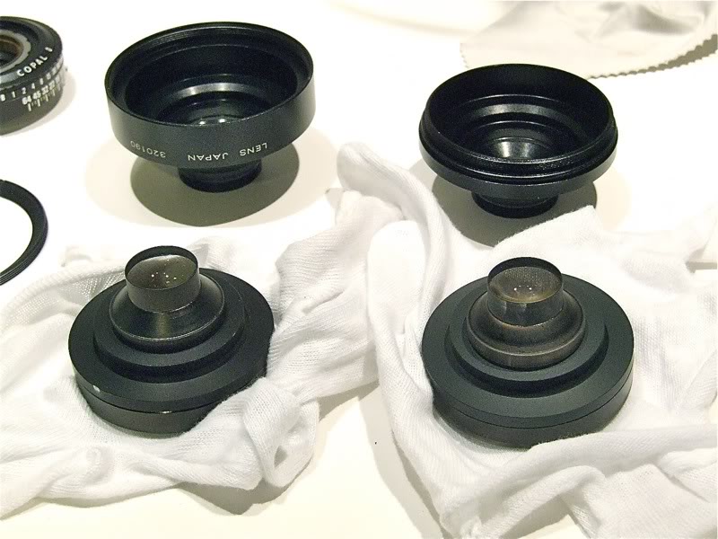

I have done that a few times. One time to change scratched glass for clean identical glass from a Schneider to a Durst barrel for my enlarger.
The other to change separated elements for clean identical glass from Caltar to Horseman housings for Horseman camera. It was pretty easy, but neiter of those lenses had a focus helicoid.
I was lucky that in both cases my research indicating the lens elements would be the same was correct. In spite of the lens barrels having different branding and shape.
