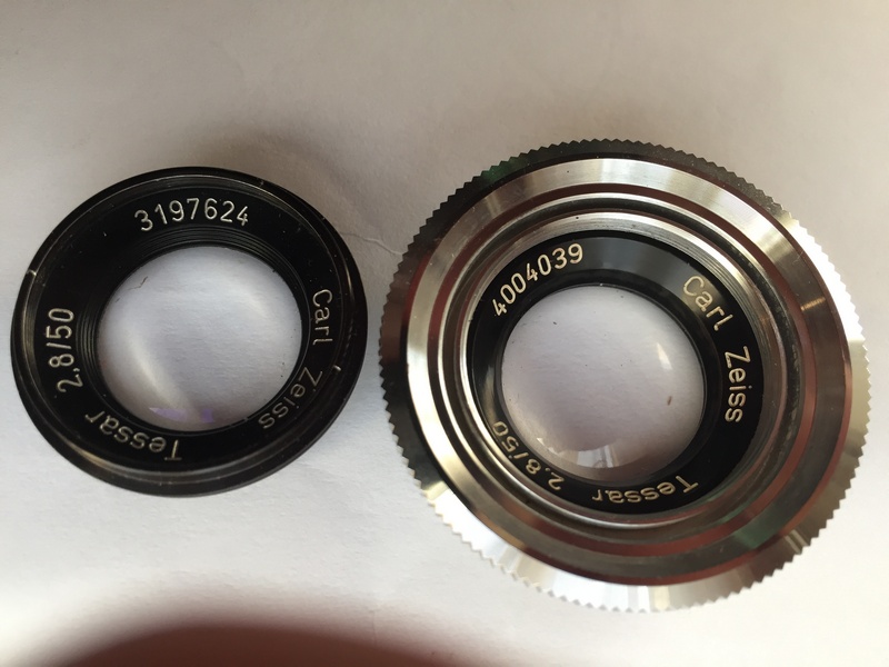

I have a Contaflex (late model, Super or similar) with damaged (cloudy) coating on front surface of the Tessar 50/2.8. S/N 4004039.
And a Contessa LKE (not The Contessa) where the body has been bent beyond repair, but the front cell of the Tessar 50/2.8 is OK. S/N 3197624.
Both cameras are from about the same era (mid-sixties), and both front elements (glass) seem to have similar diameters, 19mm give or take a few 1/10. Hopefully Zeiss opticians did not re-compute different Tessars for same-era cameras.
I'd like to transplant the good glass into the Contaflex front cell. Both cells seem to have the glass fastened by the front ring (with Tessar, etc engravings) screwed in. But no slots in that ring.

@Dan Daniel. The silvery metal is just one piece. And when the black engraved ring is separated, the glass will be free. So it needs to be replaced by glass, not by a metal/glass cell. And, the rear thread of the #319 is smaller --22.5mm-- than the front thread of the #400 --26.5mm ID, corresponding to 27mm Contaflex filter thread. And... axial distance.
Maybe not obvious on the picture, but the metal mount of the #319 has a similar two-part structure, the only difference being that the outer part (receptacle) is smaller (and black). Same 27mm thread for filters and 28.5mm outer diameter for push-on Proxars. Possiby I might even swap the #319 retaining ring into the #400 mount.

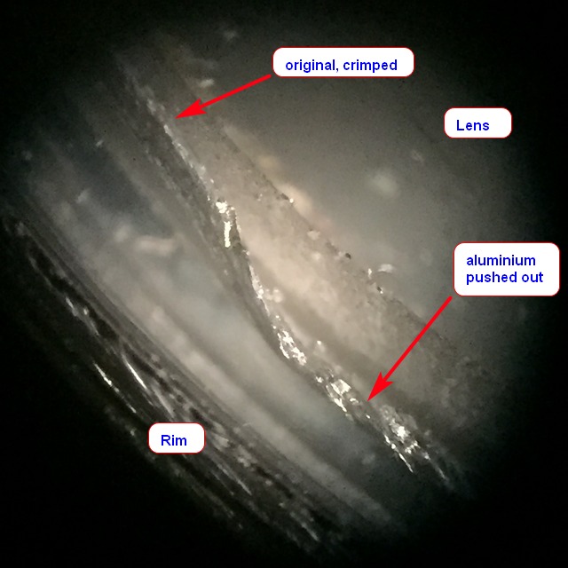

The Contessa LK Tessar mount is in fact one piece. The lens is crimped on the rear rim by a ring of soft aluminium that must have been pressed when fabricated. Using a cutter blade under a low-power binocular microscope, I pushed that aluminium lip outwards and could separate the glass element from the mount. See first pic.

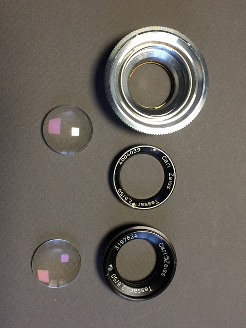

The Contaflex Tessar front element is mounted in a more "normal" way. Drilled two small holes in the front ring to gain a good grip with the lens spanner. See second pic for a group picture of the two Tessars, unmounted. Note the stronger reflection on the front side of the de-coated Contaflex Tessar.
The good news: both front elements have the same diameter: 19.51±0.01mm.
The bad news: they do not have the same edge thickness; the Contaflex one is thicker. So, the Contessa Tessar fits snugly in the Contaflex cell, diameter-wise, but with the holding ring screwed in, there remains some axial play. And, even if the mechanical fixation were good, the difference in thickness would probably mean a change of the infinity setting, which should not be adjusted because compatibility must be preserved with Pro-Tessars. And that is before worrying about loss of optical quality.
